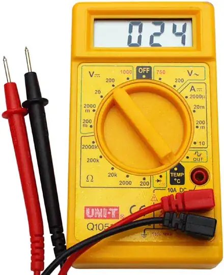

You do not need to know if there is a 'signal' you just need to know if there is a connection.
A basic tool that can tell you evetrything and costs a few bucks/quid at local hardware store. Multimeter
Never in my life did i have to use a tone generator, a oscilloscope to test if my CCTV, Satellite or TV connection is giving me good enough signal.. LOL
You use that type of equipment for digital/analogue testing where you control several if not hundred outcomes, synchronization and high speed data transfer.
You just need to use a few simple free (brainpower) tricks.
Point A being nearest to your TV and Point B being the other end of the cable.
  1. Disconnect all TVs
  2. Short point B (so connect the signal and shield with a wire)
  3. Test point A with a multimeter set at Ohm
Results
  • ~0Ohm or very close to - Woohoo you have a nice connection from a to b!
  • 0Ohm More than dead short - You have a bad connection somewhere
  • No reading - Cable form Point A to Point B has no connection
There is no need to analyse the signal or test for a signal because you know you have a signal in the other TVs (assuming the coax is connected to the same place)
Alternatives
If you know the coax for all the TVs is the same cable you, you can leave Point B terminated - which is most likely closest to the antenna or after the junction. Test Point C,D...Z respectively to make sure there is a good connection.
Take your TV and connect it to a working plug to make sure the TV is not broke - or as pointed out use TV that works and plug it into your outlet - same difference I think? (but does not eliminate double jeopardy - your TV might still be knackered as well as the signal be broke :) )
Alternative 2
Also requires for all plugs to be disconnected from all TVs. Connect a 9 volt battery to one end and test all the ends for a voltage. If you get ~9 volts then the route is good. If you get a <9V then you have an issue on the route (micro short?) if you have 0V then there's no connection
Good Luck

    Regarding the last sentence, we actually did the reverse, and connected the TV from another room to my outlet; it didn't receive anything. – Bart van Heukelom Jun 22 '12 at 13:07
  • Ohh- well then the connection is bad.. simple as.. you need to find where its broken- you dont need to test signals.. :-) – Piotr Kula Jun 22 '12 at 13:11
  • Yes, the cable guy already determined that :) – Bart van Heukelom Jun 22 '12 at 13:13
  • Ok :) Soooo you gonna need to find the closest point to where the cable starts working(ie has 0ohm on a terminated cable) repalce the broken bit and join it up again.. and viola.. PS is this Digital Cable or Antenna like Freeview Digital? – Piotr Kula Jun 22 '12 at 13:16

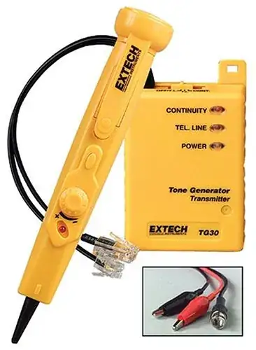

You can use a Tone Generator to find where the break in the cable is. It's still not a free option, but definitely cheaper than a signal generator. If you have a friend or relative in the phone business, those guys always have one of these in their tool belt. IT guys quite often have them too.
I'm honestly surprised that the cable guy didn't do it for you, it would have been quicker to find it for you than to explain it to you. I guess they take the premise wiring limitation pretty seriously.

  • This is a less expensive model with good reviews. http://www.amazon.com/Sperry-ET64220-Tracker-Tracer-Master/dp/B00279JLBQ/ref=pd_cp_hi_0 – Dave Nay Jun 22 '12 at 12:46
