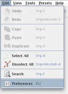

  1. Edit -> Preferences
  2. click the globe for connection settings:
  3. choose the Use OAuth radio button at the top of the dialog
  4. click the New Access Token button
  5. Add the OSM username/password you just created and click Accept Access Token
  6. Click OK at the bottom of the preferences window.

  1. From the top menubar choose Edit -> Preferences
  2. click remote control icon on left which looks like this:
  3. check Enable remote control
  4. check Download objects to a new layer
  5. click OK
Now JOSM is set up properly (when you click on links in the task manager, the data will automatically open in JOSM). You will need to restart JOSM for this to take effect.
