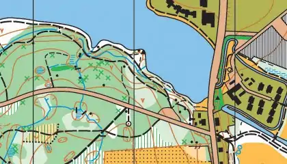

Example of a foot orienteering map with IOF symbols.

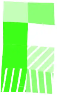

In order to make IOF orienteering maps that draw areas and cliffs with patterns the renderers need to be patched to be able to do this.

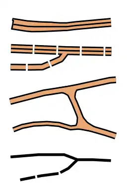

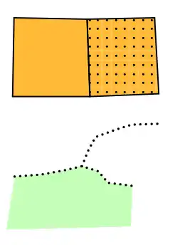

Current rendering problems or where improvements would be good:
  • Ruin with dashes (gaps in the middle of the segments / only draw corners)
  • Major power line (without fill in middle). Rendering as an Area? Maybe, modify osmarender to use the SVG masking feature
  • Add/move/delete tags/markers on lines. Need to adjust the position of markers on lines, if they not appear where they are wanted. Possible solution: "tags:yes/no/indicated/unlessindicated"
yes - as normal
no - not at all
indicated - tags on nodes with tag:yes
unlessindicated - tags on all nodes except tag:no
  • Can not do line tags with varying length (e.g impassable cliffs)
  • A (large) erosion gully, has to be rendered as an area (can not do pointed ends nor varying line width)
  • Path junctions (visible/indistinct)
  • Path crossing with streams, bridge or not.
  • Crossing points (on fences etc.) have to be done as a line now, want fixed-size crossing point (as node)?
  • Firing range: Small rendering error (line behind arrow)
