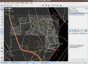

I have encountered THOUSANDS of untagged /unconnected nodes, you can remove them like this. http://osmopenlayers.blogspot.com/2010/02/remove-points-that-are-not-connected.html
  1. Load the point osm layer into JOSM
  2. Create a new layer and download the OSM data for that area into it.
  3. Make a screenshot and post it to the wiki
  4. Trace over the major streets in the point data, for trails that have only one tiny amount of points, look if you can see some streets in the landsat and yahoo wms layers.

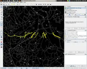

You will want
  1. Upload the new streets layer into OSM. Delete the point layer.
  2. RUN THE VALIDATOR-- there are many duplicate streets!
  3. Write the changeset ID into the Table like this: | [http://www.openstreetmap.org/browse/changeset/3751578 changeset]
  4. Mark the finished column as yes, or put notes about problem in there.
  5. Please run the validator plugin from josm. I have found lots of problems.
  6. Please run the validator plugin from josm. I have found lots of problems.
  7. Please run the validator plugin from josm. I have found lots of problems.
  8. Have fun!
