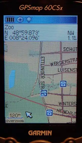

This was tested on my Garmin GPSmap 60CSx. Works well except the zooming stuff (see below).
On the Garmin Vista Cx, sendmap is unnecessary - copy map.img to /Garmin/gmapsupp.img on the micro-SD card, either plugging the unit in via USB or separately in a card reader device. Zooming does appear to work on this device, but not all roads appear to render (highway=tertiary in particular). This can be fixed by editing osm2mpx.xml & adding tertiary with secondary.
