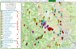

Usage
The idea is to show anomalies identified in the OpenStreetMap data on a map.
Filter settings
In the upper left are several filters which can be used for only showing issues matching the filter settings. To see all filter options, click on "More filters".
  • Severity: Show only issues with marked with a specific severity levels: High, Normal and higher, All, Normal only, Low only.
  • Fixable: Show issues which have a proposed corrections (the fix).
    • Online: A fix that can be applied via the online Osmose tags editor.
    • JOSM: Are fixes that requires a more advanced editor as JOSM. These fixes need a manual repositioning of object in addition of modifying tags.
  • Topic: Show only issues marked with a specific theme, such as roads, cycling, sport.
  • Country: Show only issues in a specific country or region of country.
  • OSM Username: Show only issues last modified by this username.
The list of categories
The list on the left groups issues into several categories, each with a specific colour. Each item has its own glyph and can be activated or deactivated to filter the contents of the map. Some items may combine several analyses of the same kind.
The slippy map
Osmose is build upon a Slippy Map. The number of displayed issue markers is limited. Zoom to show more. The markers on the map will open a popup on click.

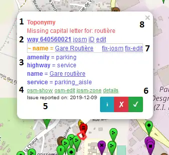

The information popup
Example of an information popup when clicking an issue marker.
When you click on one of the issue markers, a popup appears. It contains:
  1. The type of issue
    and a brief description of the issue, with optionally some focused problematic details about this object.
  2. The identification of the problematic element(s), with for each one:
    • type and identifier of the element ; the link goes to OpenStreetMap.org to show the default map centered on that element, opening the element browse panel (with all details for their actual current tags, version, links to show its history, and options to edit it there with the default editor...) and marking its geometry on the map.
    • josm – a link to the JOSM editor to load this element; JOSM must be running and the JOSM remote control must be enabled.
    • iD – a link to the iD editor to load this element.
    • edit – a link to the internal Osmose tags editor for this element ; this opens a panel on the right of the map
  3. The list of all tags for this element when the issue was detected.
  4. Some links to display the area containing the element (as it is currently in the database, without any fix):
    • osm-show – display the area on ​​the default map of OpenStreetMap.org
    • osm-edit – edit the area in the default editor of OpenStreetMap.org (iD or Potlatch, depending on local user preferences)
    • josm-zone – load data in the area into the external JOSM editor; JOSM must be running and the JOSM remote control must be enabled.
    • details – open a new browser tab with full details about this detected issue.
  5. The last date this issue was detected (and still not closed).
  6. Buttons:
    • Help on OSM wiki: open a new browser tab with help about this specific type of issue on the wiki and tips on how to fix it (see the list of issues).
    • false positive: if the issue reported by Osmose is not an error in fact, then it is a false positive (except spelling errors). An issue marked as a false positive will be masked by Osmose (as long as the element version is not changed). It is not possible, so far, to write descriptive information on about false positive cases, but the list of false positives can help improve the analysis performed by Osmose. If the element is later modified, it may reappear on the next analysis.
    • corrected: issue will no longer be shown on the Osmose map; if the applied correction is not sufficient in the current version of the element, it will reappear again latter. Remember to mark as corrected the issue you corrected by your edits. This allows everyone to follow the correction progress. If you don't click this link, but the issue has been worked on and corrected, this issue will disappear automatically on the next analysis.
  7. The suggested tags correction (with + for adding a missing tag, for deleting this tag, or ~ for modifying it).
    • The fix-josm link applies this correction in JOSM; JOSM must be running and the JOSM remote control must be enabled. Only that element will be loaded with the corrections applied.
    • The fix-edit link applies this correction in the internal Osmose tags editor
  8. close the popup

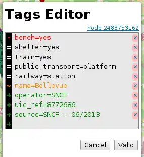

Osmose integrated tags editor
Osmose tags Editor with a deleted tag, a modified one and three added
Osmose allows direct correction of issues through an integrated tags editor. It allows you to view erroneous elements edit their tags. To use the editor you must be logged in Osmose with your OSM account.
  • In red, overstriked and preceded by a sign, the existing tags that will be removed when saving; the cross × button on the right will restore them to preserve their original value.
  • In black and preceded by a white = sign, the existing tags that will be kept unchanged when saving; the cross × button on the right will remove them when saving.
  • In orange and preceded by a ~ symbol, the existing tags whose value will be changed when saving; the cross × button on the right will restore them to preserve their original value.
  • In green and preceded by a + sign, the new tags that will be added when saving; the cross × button on the right will remove them, these tags won't be saved.
Tags are free fields. They must all contain a key and a value separated by an "=". The last line is always empty after the + sign, and allows adding a new tag.

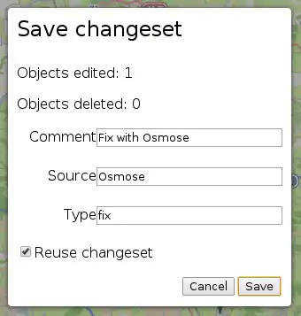

When you press the Valid button, changes go into a queue. They are sent to the OSM server when you follow the link "Save" on the main menu. The Valid button automatically set the issue marker status as corrected. Note that the queued data is still not applied to the OSM database, it is kept only with your personal online session, even if the marker is no longer visible on the "Osmose issues" layer.
Osmose tags editor before sending to OSM servers
In the Save window, the changeset input fields (Comment, Source, Type) will be stored in the changeset's tags. The "Reuse changeset" checkbox allows to reuse, if possible, the last changeset that Osmose has created rather than creating a new one.

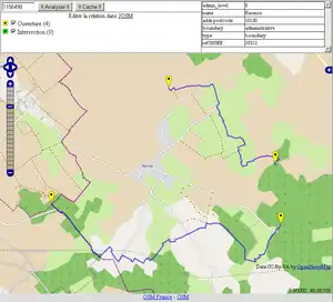

Analyzer relationship
See Servers/analyser.openstreetmap.fr (disfunctional)
administrative border drawn by the parser
This tool is an addition to the issues "open relationship", "self-intersection" and "too many ways" in "administrative" in the slippy map. It allows you to check after sending a modification to the server, if the errors have been corrected.

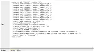

Raw Data Editor Rawedit
A relationship edge Administrative displayed in rawedit
Osmose allows correction of errors by the simply editor rawedit. Its use requires a sufficient understand of language XML and an identification OAuth with OpenStreetMap.
It is possible to make permalinks to the editor as crude http://rawedit.openstreetmap.fr/edit/relation/123456
This editor lets you make changes to any object type, especially the complex and long to load in other editors.
