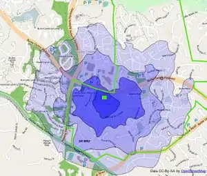

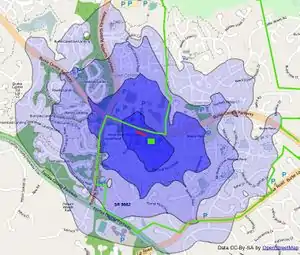

Isodistance maps
To create these, we must take our road+path network and create a shortest path tree (SPT) via something like Dijkstra's algorithm, and then create contours or interpolate to get a gradient effect.
pgRouting has a function driving_distance() which computes the SPT using any arbitrary cost, such as distance or time, and returns the vertices and their accumulated cost. GRASS has v.net.iso which is very similar, but returns edges and their accumulated cost. Many other libraries exist which implement Dijkstra, such as Boost.
A non-trivial task is properly assigning weights to edges, taking into account OSM attributes like highway=*, maxspeed=*, and many others. It may be worth extending OpenTripPlanner to take advantage of the existing attribute handling as well as the multi-modal functionality.
Currently I'm doing the following: Download virginia.osm.bz2 from Geofabrik, extract Fairfax County, then import using osm2pgrouting:
wget http://download.geofabrik.de/north-america/us/virginia-latest.osm.bz2 osmosis --read-xml file=virginia-latest.osm.xml --bounding-box left=-77.5755 top=39.0718 right=-77.0334 bottom=38.614 --log-progress --write-xml file=fairfax.osm.xml osm2pgrouting --file fairfax.osm.xml --conf mapconfig.xml --dbname fairfax --username postgres --passwd postgres --clean
I then have a Python script generate filled contours, based off of the Contour plugin for QGIS:
- Execute SQL query or load file using OGR to retrieve vertices with costs
- Interpolate irregular data onto a regular grid using griddata from matplotlib
- Create filled contours using contourf from matplotlib
- Convert to GeoJSON or other file using OGR
To show this on a map, I have another Python script which takes a start point via HTTP POST (walk.py?startpoint=$lon $lat), finds the nearest vertex, computes the SPT using driving_distance(), creates the filled contours, and spits out GeoJSON for consumption and display by OpenLayers.
