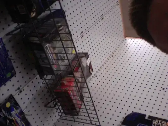

The filmsy metal bits between the walls
More flimsy metal bits between the walls
A pegboard wall in use.
Close up of a pegboard wall in use.

The metal things in the walls are metal studs, used in place of wooden studs. In other words, these walls are built like any other interior wall, facing material over framing, with appropriate attention to possible fire hazards and so on.
Pegboard is perforated hard board, not hardwood.

Normally you would mount the pegboard either directly to studs, like in a garage, or on top of 1x2 furring strips attached to the studs. If you wanted to get fancy, you could build a frame around it. There are also metal pegboards.

The metal pieces holding up the pegboard are simple metal studs. You can find them at any big box hardware store.
As a more approachable alternative, rather than using metal studs, you can use wood studs to frame or float walls and attach the pegboard to those. There are many, many tutorials online that describe different ways to frame a floating wall so I won't post that here. Every situation is different.
If you attach pegboard directly to a finished wall, make sure you use furring strips (just thin pieces of wood) to space the pegboard away from the wall so the metal hangars have space behind them to hang properly.
