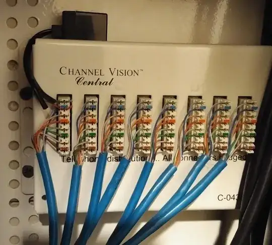

My house is wired for Ethernet, and it uses RJ45 jacks wired with Cat5 cables for POTS. I have no use for POTS, and I'd prefer to repurpose those jacks as additional Ethernet jacks. The Ethernet and telephone cables all end up in a central wiring closet, and the telephone cables are wired to a Channel Vision C-0438 distribution box:
The Channel Vision C-0438 in my wiring closet
To make it easier to repurpose cables (by disconnecting them from the distribution box and connecting them to an Ethernet switch, or vice versa), I am considering replacing this distribution box with a Channel Vision C-0436, which uses RJ-45 jacks. Would there be any disadvantages to this?
(As far as I can tell, each telephone jack in the house corresponds to a cable connected to the distribution box, so I don't think any of the cables are spliced.)

  • @Craig The home was built in 2007, and I presume that the wiring is cat5e. The cables don't seem to be explicitly labeled with "cat 5e", but they do have "5E" printed on them (although I'm not certain that I'm not misinterpreting the label): 266 FT E164061 VERIFIED (UL) CMR OR MPR 5E 350 MHZ TO TIA/EIA-568A 24 AWG 4 UTP C(UL) DEVICE A B C D E F ZONE 0 1 2 3 4 5 6 7 8 9 – jamesdlin Oct 09 '16 at 04:57

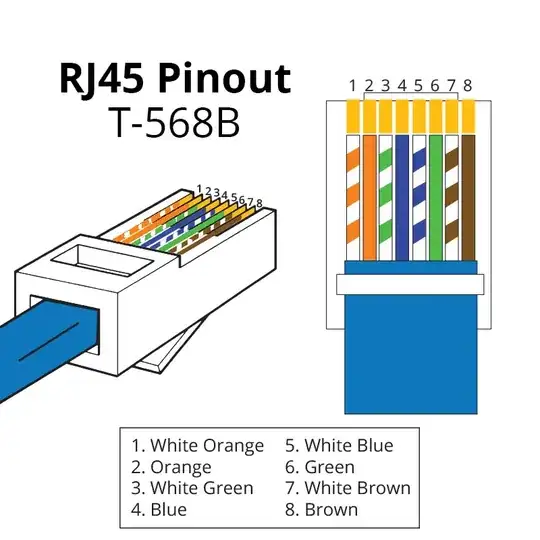

What you're really looking for is a Cat 5e (or better), T-568A or T-568B compatible punchdown block with RJ45 jacks. That's TIA/EIA-568 revision B, which is essentially identical to the older AT&T 258A (Systimax) standard, which was originally designed for telephone service. T-568A and T-568B are electrically compatible as long as the same standard is used on both ends of each segment. T-568A is still the official data networking standard, but a lot of vendors use T-568B. Whichever; just make sure the same standard is used on both ends of each individual length of cable.

You'll want to confirm that your RJ45 wall jacks are wired up to the T-568B standard.

The distribution box you show is designed only for telephone signals. If you want to use the cabling for ethernet there are a few changes you need to make:
  1. With POTS telephone wiring all of the wires are connected together. All the orange wires are connected to each other, all the blue wires are connected to each other, etc. That's why every phone in the house rings at the same time.
Computer networks do not work like that. With a computer network each jack needs to be independent and connected to a network switch. The standard way to do this is to have each cable run connected to a patch panel and then run short ethernet patch cables to the network switch. However in a small home environment it is probably easier to just crimp an 8P8C modular connector (a.k.a. RJ45) onto the cable run and then plug that directly into your network switch.
The Vision C-0436 item you link to looks basically the same as the one you have now: everything is all tied together. So it would not be usable for ethernet.
  1. The above point is far and away more important but I also want to point out that the way the wiring is done in your photo is fine for low-bandwidth POTS but not ideal for ethernet networks. You can look up tutorials online for how to "punch down" cabling but in brief you want to keep the cable twists intact for as long as possible and avoid excessive unraveling.
  2. Finally on the other end of each wire you will need to make sure the jacks are wired properly. Telephone signal only uses 2 conductors but ethernet uses all 8. Depending on how it was originally wired you may need to redo the punch-down and/or even replace the wall jacks entirely.

  • Sorry, I wasn't clear. My plan would be to replace the box to make it easier for me to disconnect a cable from the distribution box and instead connect it to a real Ethernet switch (and to later reconnect it back to the distribution box if someday I sell the house). – jamesdlin Oct 09 '16 at 03:04

  • @HenryJackson Yes. My goal would be to be able to easily repurpose one of the cat 5e(?) cables from telephony to Ethernet (and back if necessary). – jamesdlin Oct 09 '16 at 17:58
