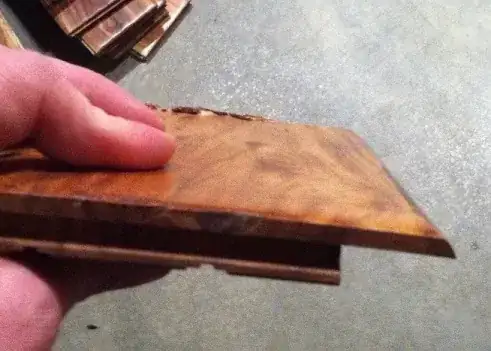

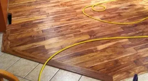

I ended up taking advise from @chris's answer and making my own transition from actual flooring. I cut away part of the flooring to make the transition piece sit flush on the floor and then on top of the tile. I then routed a rounded edge so the piece on top of the tile flowed down more gradually.
I was a little worried about the routed part and how it would look compared to the top (finished) of the flooring. But with a little flooring varnish, and then a rub with some scotch brite to dull the finish, it was a perfect match. This worked because the wood was not stained, and natural in color. If it has been stained, it would have been a little harder to match.
We are very happy how it turned out. It's a smooth transition, more so than an actual transition piece like a T or reducer since it does not rise up higher than the hardwood floor or the tile.
Here is a pic of a cut away piece with the routed edge:
Here is a pic of the finished transition:

    This is a very elegant fix. I particularly like that there's no additional rise above the hardwood height. – gregmac Jan 06 '14 at 18:17
