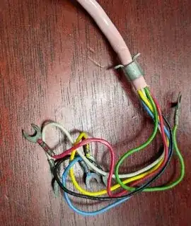

What you are looking at is a terminal block where a desktop telephone was once connected. The wire which disappears into the plaster wall runs downstairs to a larger terminal block where it is connected to the phone line from the street. These basement terminal blocks were originally quite large, like the one discussed in What is this electrical device in my basement? and installed in the basement. Later they become smaller and where frequently installed on the side of the house.
Pigtail on end of phone cord
Up into the mid 1970's your typical home tabletop telephone would have a pigtail with spade lugs at the end of its cord rather than a plug. The spade lugs would go under the heads of the screws on this block.
Strain relief clip installed in socket
There would be a metal clip crimped onto the cable sheath right at the end. The part of the cable with this clip would be slipped into the slot you see at the top of your terminal block (bottom in my photo) and the little plastic nubs on the block would prevent it from coming out.

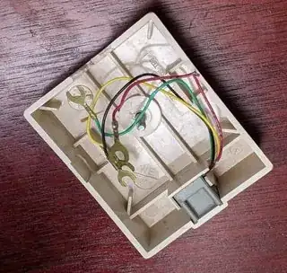

Terminal block with cord and cover in place
A plastic cover with a slot for the cable to exit would be slipped over the whole block and fastened with a screw in the center. (You can see where the screw goes in the center of the block.) This was done by a telephone installer from the phone company.
When a telephone was installed in this way, the customer could not move it to a different room. The phone was rented from the phone company and had to be returned when service was canceled. When you called to cancel service, they would tell you to take a pair of scissors and cut the cord and drop the phone off at their office. It was common to see eight inches of cord hanging out of these terminal blocks when you moved into a house which had been previously occupied.
If the customer wanted to be able to move the phone around, the installer would install a four-pin surface-mount jack instead of a terminal block. A four-ping plug would then be installed on the pigtail at the end of the phone cord. There was also a special cover with a four-pin jack on top which could be used to convert a terminal block into a jack. But I did not see these four-pin jacks very often.
In the mid 1970's the module jack system we know today became standard. For a while the terminal blocks on the wall remained the same, installers simply used a different cover with the modular jack on the side. Now customers could disconnect their phones without cutting the cord and shortly after that they got the right to connect their own phones bought in department stores. The replacement covers with the jack were also widely available in stores.
The dangling cable in your photo runs or used to run to a second phone jack installed later. Rather than running a new wire from the basement, the installer simply extended the existing wire using the old terminal block as a splicing device. (Sometimes they would install jack covers in both locations, though if that had been done here, I would expect to see the broken off spade lugs, but I don't.)
