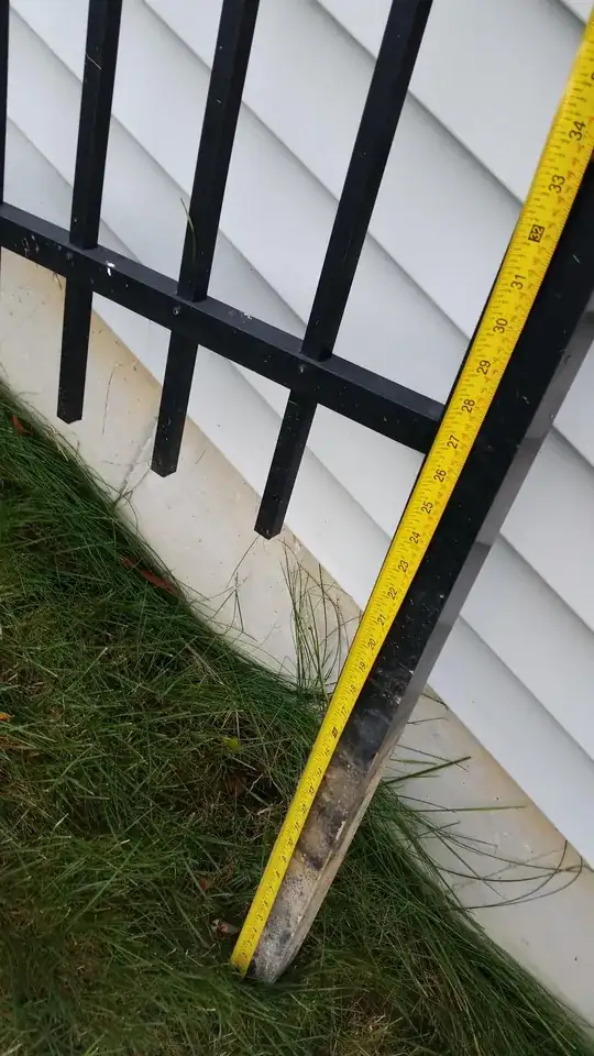

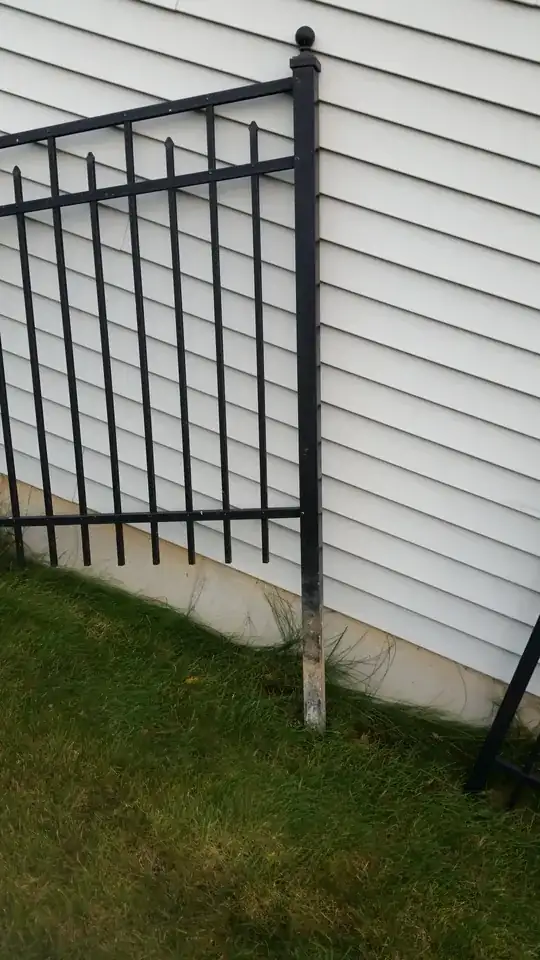

I recently moved into a new home in upstate New York which has a fence around the backyard. The fence is made out of some kind of metal and the fence posts are about 2" square. One of the fence posts had risen a few inches since it was first installed due to frost heave. It had been set in a concrete footing and the whole footing had risen. I have dug out and removed the concrete (by my estimates it had gone down 33±3") and now have a roughly 40" deep hole approximately 9" in diameter. The fence post itself only goes about 20" into the ground.

Here are a couple pictures of the fence and post: fence and post enter image description here

  • That was probably a good choice. Those fences are sometimes wrought iron and sometimes aluminum. It was originally in concrete, but it had a good paint finish on it at the time, which doesn't look intact in the previously embedded area. If it is aluminum, the concrete would be extremely corrosive to it and could have basically dissolved a lot of the embedded portion of the post. The pea gravel was a good solution. BTW, if the ground gets wet there, the pea gravel may tend to sink into the soil. Every few years, you might want to tamp it down and top it off with more gravel if needed. – fixer1234 Jul 15 '17 at 21:21
