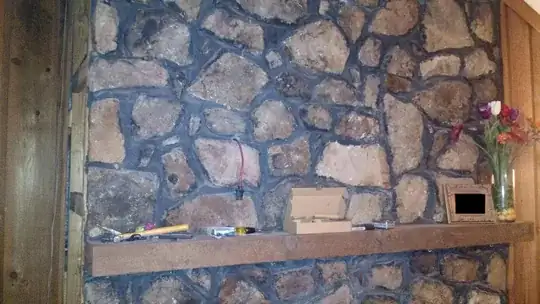

Here are some pictures--first is the front of the facade, for reference. Stone is 8' (2.4m) wide, by maybe 12-14' (3.7-4.3m) tall. Note the power wire expertly run through the mortar just left of center.:

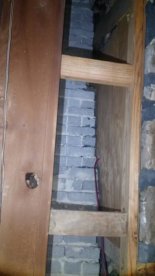

Looking in from the left, behind the facade. Note that same power cord coming through, for reference. The plywood sheet on the right of this picture is behind the stone facade:

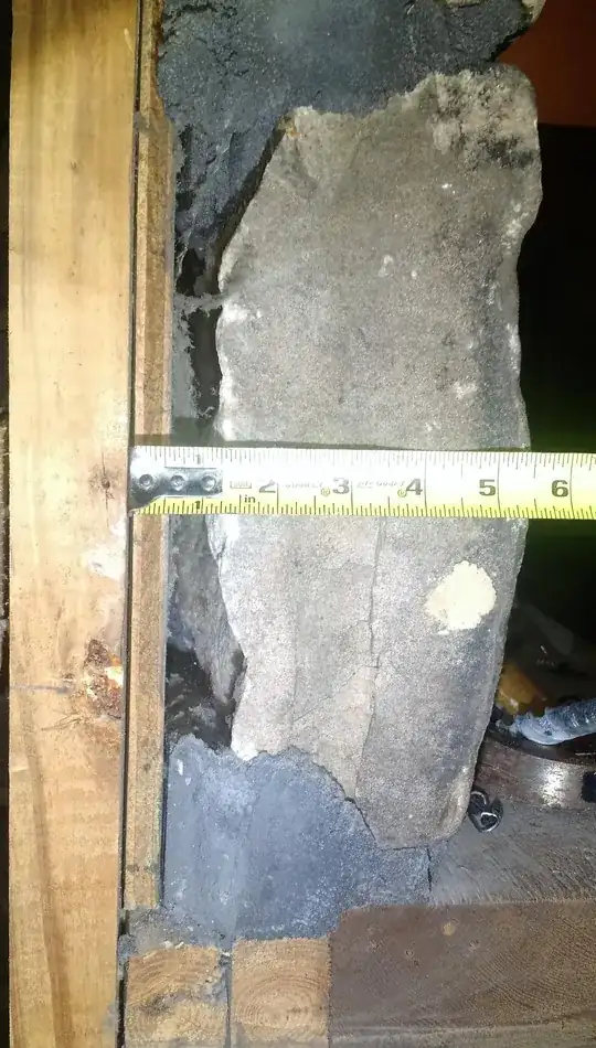

Here is a profile picture of the facade, with tape measure for scale. Here you can see the stone facade from the side.:
