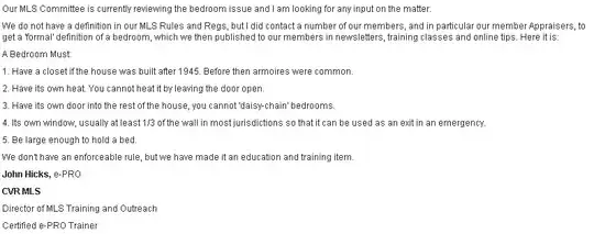

enter image descriptionhere
I did find some information that suggests that the Multiple Listing Service (MLS), does require a closet when defining a room as a bedroom.
Source
Your best bet would be to contact a local real estate agent, and ask them if they would list the room as a bedroom.
