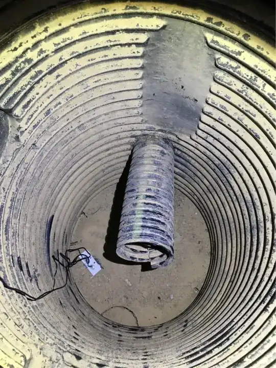

I have a sump pit in my basement with a pipe that comes from the drain tile. The drain tile does not see day light anywhere, it's all near the footings of the foundation.
I can feel a strong flow of air coming from the pipe. Where would that be coming from? Is that normal?
Here's a picture. The top of the picture is the exterior wall of the house, the pipe is coming in from the drain tile. pipe

I am a residential builder, but I would suspect this "air flow" is best explained through psychrometrics and the concept of "natural draft".
The air inside the drain tile system will likely be much cooler than the temperature in the basement. That temperature difference begets a pressure difference, with the cooler air being more dense than warm air. Nature, forever seeking homeostasis, tries to reconcile the pressure difference between the two areas..... and a draft is formed.
This phenomenon can also be known as the "stack effect" when dealing with building construction, and is one of the causes of thermally inefficient homes. Improperly sized HVAC systems and things such as ventilation fans in bathrooms and range hoods will also serve to depressurize the house.
From a building inspector's point of view there is absolutely nothing to be worried about.
