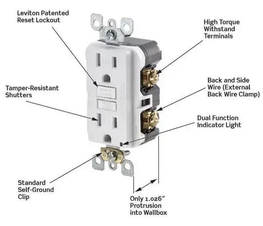

I had to rebuild a piece of my house that had a (working) GFCI outlet on it. I purchased a new GFCI outlet, as the old one had a piece of broken plastic. I wired it up, being sure to put the white wire on the silver screw, black wire on brass, and avoiding the terminals with the sticker over them used to feed other receptacles. The outlet worked fine for a day. In case it matters, it's almost exactly this model:
Leviton X7599-W SmartlockPro Slim GFCI Tamper-Resistant Receptacle with LED Indicator, 15-Amp
