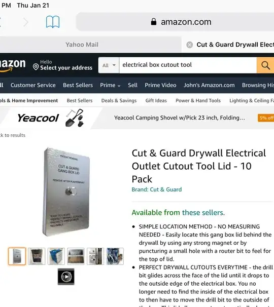

I recently invented a new product called the Cut & Guard Gang Box Lid specifically to protect the wires as well as to simplify the cutout process. It’s an inexpensive simple lid that goes on top of the electrical boxes to protect all the wiring. It also makes it easier to cut around the electrical box with a rotozip because you no longer have to jump the drywall bit from the inside to the outside edge. The lid prevents the drywall bit from plunging into the top of box or from cutting into the box from the sides. Another benefit is that it keeps the box clean from mud and paint. Hence making it easier for you to finish wiring. enter image description here
JFarn
  • Can you disclose any affiliation you have with the product? (If you don't, just say so) – ThreePhaseEel Feb 03 '21 at 00:41
  • Yes I invented this product specifically to protect the wires and also to make it easier to cut out the drywall around the outlets. I have built several homes and even with professional drywallers I would have several damaged wires. – JFarn Feb 03 '21 at 01:51
  • Ah, good thinking -- do add that to your post though using the [edit] link on its bottom left – ThreePhaseEel Feb 03 '21 at 01:53
  • Sounds good. I am new to this forum. Thanks. – JFarn Feb 03 '21 at 01:56
