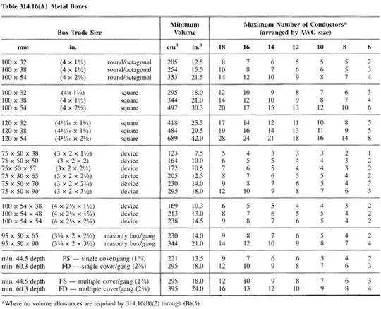

  • We have rules on "box fill" or how many wires are allowed in a box. You have to run the proper numbers, but for a wild guess that's in the neighborhood, think 2 cubic inches per wire. You might want to consider 120mm boxes since they allow about 40% more splices, but they're harder to get covers for.
