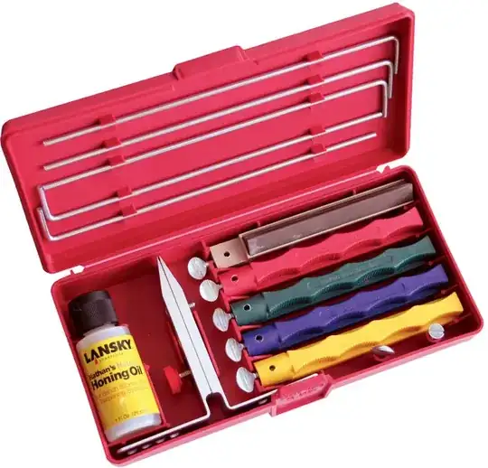

You need to look for a sharpening system that takes care of angles for you. Here is 2 choices that were recommended to me by knife maker-hobbyist (I'm not affiliated with any of those)
This sharpener system supposed to work very well but I watched video and still wasn't sure I can maintain angle :)
After I got this set - I sharpen knives in no time and I never was able to do it before with just a stone. Angle is perfect. I bought simple set but I got yellow stone later. With yellow stone - it just makes it perfect. I use 17 degree for my Shun knive, I had to make new edge because I think factory is 16 degrees for those. And I use 20 degree for German knives

  • There is no problem with you linking to a specific product, or providing an image of said product to demonstrate your point. The only catch is, if you are affiliated with that product you must say so. Here at DIY.StackExchange we love tools, and are always looking for an excuse to buy new ones. – Tester101 Dec 03 '11 at 15:09
  • Post edited - This red box is what I have and now I can say I'm able to sharpen knives :) – katit Dec 03 '11 at 15:43
  • It would help if you included links. I identified the red box as a Lansky Professional Sharpening System, http://www.amazon.com/Lansky-Professional-Sharpening-System-Serrated/dp/B001KN3OKO ... but I'm clueless on the first one. – Karl Katzke Jan 16 '12 at 01:30
