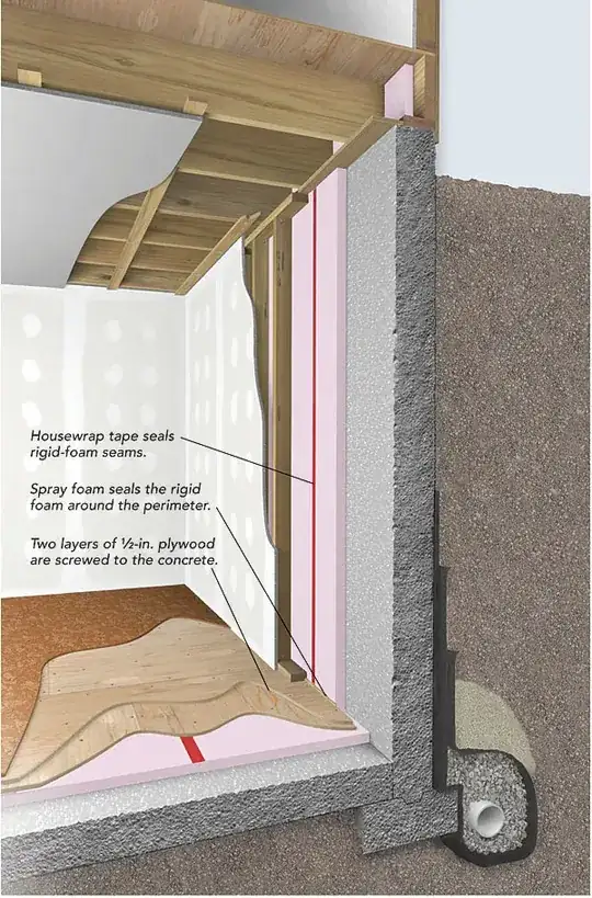

I intend to finish a part of my basement following this guideline from Fine Homebuilding and Building Science. There are two options I could come up with for installing hydronic radiant heat extrusions, and I can't decide which of the two is most ideal.
Option 1 - Route out a pathway into the insulation that would fit the aluminum channel, then cover with the two layers of 1/2" plywood, then cover with flooring Option1
Option 2 - Start with 2" foam, put down 1/2 ply screwed into the concrete, put down aluminum channel on top of 1/2" plywood, cut strips of 3/4 plywood to go between channel, install flooring over 3/4 Option2
Option 1 is much easier to build. The foam will have some "give" when fastening the plywood against the aluminum plate, which will ensure contact and allow flatter flooring layers above. I just fear the aluminum on insulation contact, movement and directly heating the insulation. There are adhesives to secure the aluminum to the foam if that's appropriate.
Option 2 provides more "structural" support to the channel to prevent noise, as well as providing more thermal mass and more isolation from the insulation. I'm not sure if the layers of plywood will have enough "give" to encapsulate the aluminum track without causing the surface to bow.

  • Cutting plywood will be much easier and less messy than routing rigid insulation. I'd go with #2. – StayOnTarget Mar 13 '18 at 00:38
    There is also a variant of #2 where the radiant panels are "face up" so much more of the metal surface area is in direct contact with the flooring above. – StayOnTarget Mar 13 '18 at 00:39
  • What is the point of screwing the plywood to the concrete? That will introduce a massive cold bridge, for no particular benefit. (My basement floor is 25mm OSB floating on wood fibre - with a vapour barrier over the fibre.) – Martin Bonner supports Monica Nov 18 '19 at 10:16
  • @MartinBonnersupportsMonica Concrete floors aren't perfectly flat, unless you put a lot of effort in to ensure that. If you don't screw it down, it _could_ have spring to it depending on how thick the plywood and the size of the peaks and valleys of the concrete. If you knock down the peaks and do 2 layers of 3/4 plywood screwed together, I think that's safe to float without securing to the concrete. That being said, interesting thought on the screws being thermal bridges. You'd want the screws not touching the aluminum fins for sure. – kavisiegel Nov 24 '19 at 16:26
