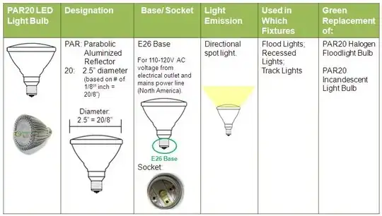

According to this site:
R20 bulbs have reflectors that direct light forward and produce more narrow soft-edged beam that is less precise than PAR20 bulbs. R20 bulbs also produce less shadow than PAR20 bulbs. PAR20 bulbs control light more precisely and produce more concentrated light than R20.
PAR20
R20
Source: http://www.agreensupply.com/difference-between-par20-and-r20-led-light-bulbs/

    In other words, an R-20 is more of a floodlight. A PAR20 will act more like a spotlight; the parabolic reflector behind the filament will focus the light kind of like your car's headlights. – KeithS Dec 12 '11 at 18:08

PAR stands for Parabolic Aluminized Reflector, by the way. The numeric part of the number is the diameter in eighths of an inch. A PAR38 will be 4-3/4" in diameter and an R20 or PAR R20 should be 2-1/2" in diameter.
