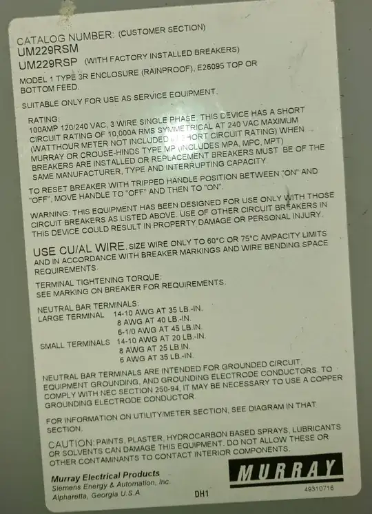

3) My current main breaker is integrated with the meter. The box is rated for 125A and the installed breaker is a 100A, 2-pole breaker. See the following picture: Main Breaker Panel with Service Meter
This one details the current panel specifications: Main Breaker Panel Specifications

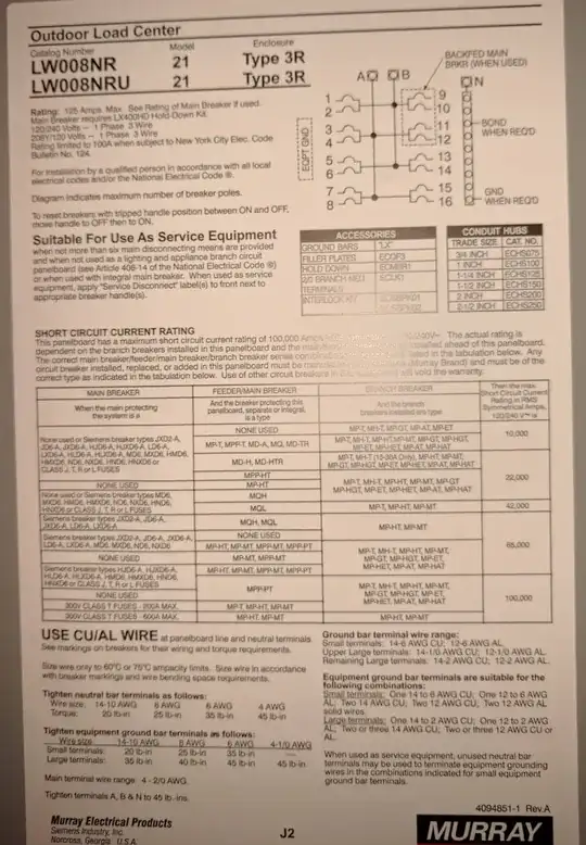

5) My subpanel is also a 125A rated subpanel. It has 8 slots for (apparently) 16 circuits. See the following picture: Subpanel Specifications

  • What's the story with the two meters? What's in the lower area of the meter housing? – Harper - Reinstate Monica Jan 06 '17 at 07:50
  • Second meter is for a different unit. It's not relevant. The lower area is the main breaker panel... Like I said, the meter and main breaker are in an integrated unit. – Hari Jan 06 '17 at 08:35
  • @HariGanti, it's actually VERY relevant. You CANNOT increase the amperage of that meter pan, nor can you add another 125A breaker. Each position of that dual meter pan is rated for 125A. What makes it relevant is that it is a dual socket. You cannot simply change or upgrade one side. Either the whole thing would need to be replaced, or your side abandoned and a new 200A meter socket installed along side this existing one. – Speedy Petey Jan 06 '17 at 12:55
  • @HariGanti, dare I say you are GREATLY over-simplifying this. It is not nearly as easy as you make it seem. And I don't know who at your utility said that meter/service was capable of 320/400. They are clearly mistaken. I assume they meant you can have up to that size service with the proper service entrance equipment. – Speedy Petey Jan 06 '17 at 12:57

Spaces vs Circuits
First let's explain the 8/16 thing, or "8 spaces but 16 circuits". At some point, panel manufacturers developed what I (alone) call a "double-stuff" breaker, which crams 2 breakers into a single space. This is intended to solve crowding problems in too-small panels.
enter image description here photo source: Home Depot
Relying on these, marketing called their boxes 2X-circuit (X-space). Around 2014 they mysteriously stopped doing that. Recent NEC changes required AFCI or GFCI breakers on damn near every circuit... AFCI and GFCI are not made in double-stuff breakers.
Your 16/8 service panel is a legacy of that bad labeling. You have an 8-space panel, intended to replace an 8-space fuse box.

More work to do at the meter
OK so the power company says their side of the cable is 320A. If they say so.
They say their meter is 320A. If they say so.
But your meter housing is not 320A.
To support more than the listed 125A, you will need to upgrade your meter housing. There's no question of that. That's your equipment and you have to pay for it, probably, unless your power company does something different with cost sharing.
You won't be able to replace parts of it, you will probably even have to replace both sides of it as a single unit. However it is very nice to have your main breaker in the meter. It means you can fully de-energize your main panel, which makes it safer for you to do yourself.

  • Is it preferable to replace the existing subpanel to increase the number of slots available, or install a second subpanel? – Hari Jan 09 '17 at 06:52
  • Depends. First, do any subpanels *need* replacement due to damage (rust), de-listing (FPE panels), obsolescence (PushMatic) or just plain cheapness (Homelite). Then, how do you choreograph it so the house remains usable during the work (in a DIY situation that can be weeks). Adding a subpanel and making the original a sub-sub-panel is a great method. Move circuits at your leisure then remove it. – Harper - Reinstate Monica Jan 09 '17 at 19:00
  • The one subpanel I have doesn't need replacement. It's actually brand new, but simply doesn't have more than 8 slots, so I'll be filling it fast. If I kept it, I'd need to add jumper wire connecting the hots and neutral going into the existing box to provide power for the new box (if I can just use jumper wire). I also don't really need electricity in the studio for a while. Would replacing a panel really take much longer than a day to bolt to the wall and wire it up? – Hari Jan 09 '17 at 19:56
    An 8-space panel won't be so bad. Depends if you run into any complications. – Harper - Reinstate Monica Jan 09 '17 at 20:01
