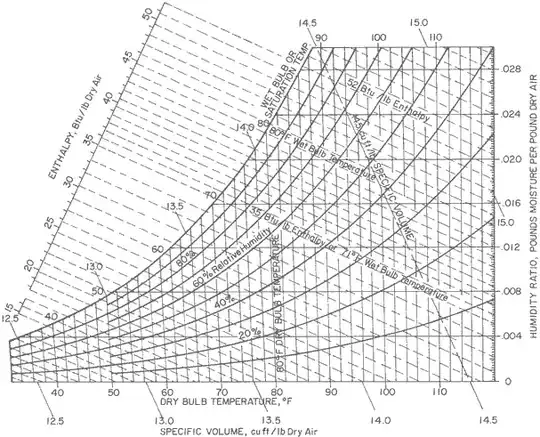

Find the intersection of dry bulb temperature and relative humidity, then follow the dashed diagonal enthalpy line intersecting that point left and up to the edge of the curved area on the chart (the line marked “saturation temp”). That is the temperature at which your air will start to deposit condensate on surfaces. As you can see on the chart, cold air with a high RH carries less water in it than warm air with a moderate RH and cold air requires even colder surfaces before the remaining water vapor will condense.
