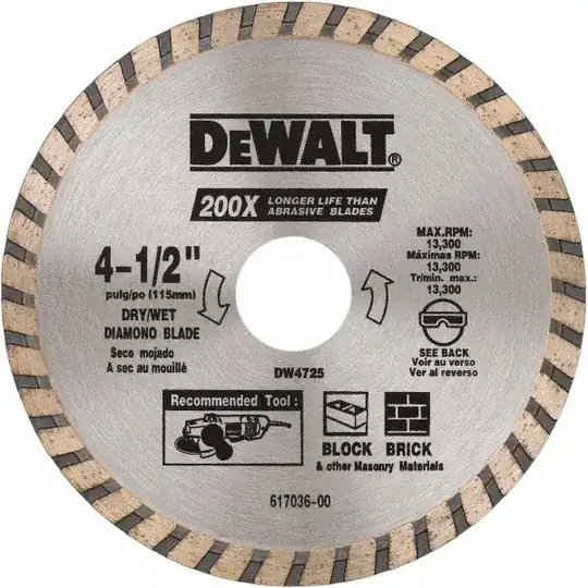

16
I own a pair of tile nippers - I bought them first, they were cheap. Unfortunately, they didn't work (pretty much "at all") on the tiles I was using - breaks would be more or less random.
Dry Diamond blade
So I bought one of these dry diamond blades for an angle grinder - if you don't own an angle grinder, this might just be one of the few times I'd say that the cheapest knock-off you can find with a warranty that's slightly longer than your project will take would be appropriate - personally, I had one already. Eye protection, dust mask, work outside or somewhere with massive dust collection. As compared to the wet tile saw, no built in fence, (I was able to set up wood to clamp tiles and act as a fence when needed) not wet so there's dust, much less expensive. As compared to the nippers, no comparison, this just works. I was even able to miter-cut some tile to make up for not being able to find bull-nose for 50 year old tile I was reusing.
Image is an example, not an endorsement. A dry or dry/wet blade is what you want for dry cutting - a wet (only) diamond blade will not be happy if used dry.
