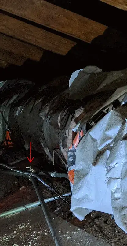

I tried to take some pictures, but my cellphone was not up to the task. This was about the only clear image I managed.Questionable wiring

I'll admit, seeing a twist-tie thing holding the cabling together is a little concerning. But I'm also surprised that none of this came up during the home inspection.

  • Also, can you tell if the flexible cable is type AC cable or type MC cable? – ThreePhaseEel Jan 22 '17 at 17:02
  • @ThreePhaseEel - Suburbs in Dupage county. – Sad Homeowner Jan 22 '17 at 17:02
  • @ThreePhaseEel - I'm afraid I don't know. Will it be labelled? I can crawl back up there and take a look. – Sad Homeowner Jan 22 '17 at 17:05
  • @SadHomeowner -- if you can get a box open that's fed by the armored cables (turn the power to that circuit off first!), do so and post a photo of the inside of the box. – ThreePhaseEel Jan 22 '17 at 17:07

  • That's a flexible metal *cable*, not flexible metal *conduit*, most likely -- and that's a *big* difference under Chicago codes. – ThreePhaseEel Jan 22 '17 at 18:18
