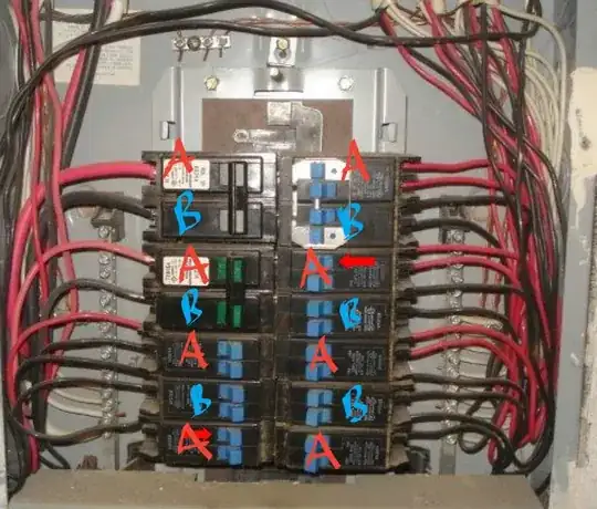

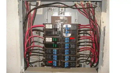

Trying to use Powerline data/control devices and need to figure out which phases in my house go to where.
The double breakers are confusing me further - and I know they alternate phases vertically but is it the same phase right to left?
Question: Are the two breakers with red arrows on the same phase?
(120v+120v=240v)

  • Your panel is fastidiously well-colored, with all the reds on the same phase, and only 4 blacks which "should" be red. It's legal to mark them as such with electrical tape. You *seriously* need a bigger service panel, though. All those blue-handle breakers are "double-stuff" breakers with 2 breakers in one space, which makes it impractical to go AFCI or GFCI. – Harper - Reinstate Monica Jan 25 '17 at 02:26
  • I know I love how clean it is, townhouse from 90's - developer must've been cutting corners.. Trying to use powerline ethernet on those two, and getting very poor signal. Must be something else// *Or perhaps something to do with the double breakers? – Observer314 Jan 25 '17 at 03:57
  • Also - wondering why the upper right ones are linked together in pairs? They go to the kitchen outlets so I don't see why they're linked unless it's code to do so? – Observer314 Jan 25 '17 at 04:02
  • Probably because they are multi-wire branch circuits. Those don't require common overcurrent trip... But they do require common maintenance shut-off. I am glad your installer had good color discipline, because it is Very Important each side go on a separate pole. – Harper - Reinstate Monica Jan 25 '17 at 04:56

  • Q1: So the 4 circuits protected by the pair of tandem breakers are linked (inner ones linked by a pin, outer ones by a plate) so that an overcurrent trip in one circuit does not pull off the mechanically linked breaker? Q2: This kitchen has four sockets (presumably in two duplex receptacles) each on a different breaker? Wow, this is a set up for simultaneous use of multiple high current appliances. – Jim Stewart Jan 25 '17 at 19:51
  • Presumable they are wired like this: https://i.stack.imgur.com/byQgv.jpg So If the top plug was shutoff but not the bottom there would still be half the outlet with power. – Observer314 Jan 26 '17 at 03:44
Yes, they appear to be on the same leg.
Unless there's something I'm missing.
  • No appears that is the correct way, thanks for labeling them! – Observer314 Jan 25 '17 at 03:53
    Q1 It is always true for US panels that the two breakers exactly opposite are on the same leg, right? Q2 If one wants to determine whether two receptacles are on the same leg or on a different leg, one measures the voltage difference between the two hots? Zero volts same leg, 240 V different legs. This will in general require an extension cord plugged into one of the receptacles. – Jim Stewart Jan 25 '17 at 08:09

  • Q1 - Appears some can line up (as mine) and some are staggered horizontally too Q2 - Good idea - will use the extension cords method next time – Observer314 Jan 25 '17 at 19:15
