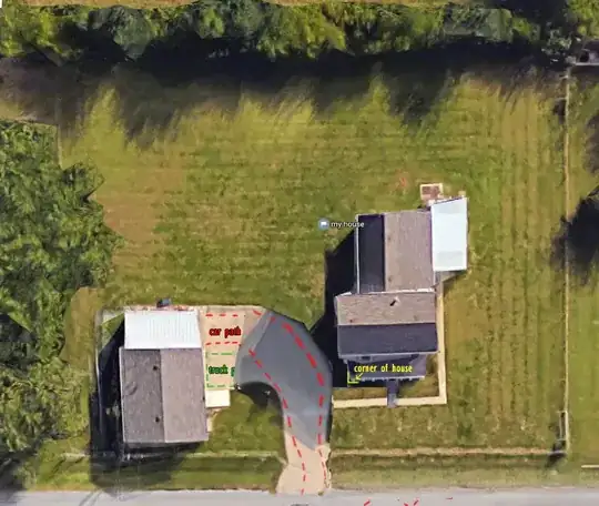

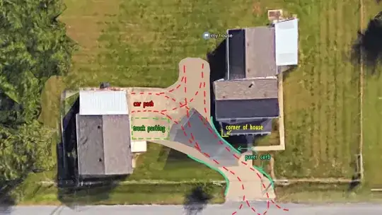

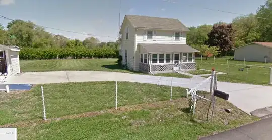

Bellow is an arial photo and a road-side photo of my new house.
As you can see the driveway is an awkward curve especially when backing out of the car port to the side of the garage - you have to do a slight "double S curve" to avoid the house and a parked car/truck. Worse yet, it come dangerously close to the house! [more info about the vehicle and parking at the end of this post]
I'm sure that after a few weeks of practice it will become second nature to navigate it in reverse, but for guests and for those rough mornings without coffee, I'm worried that a car could graze the edge of the house and cause damage to the car and the house.
So I'm wondering what my options are. What would you do? Thanks!
[edit] here's some more info for those interested: I drive a truck and the lady drives a car. She will park in the car port as shown, and I will park my truck in the driveway. The outbuilding is actually a workshop with a wooden floor and cellar underneath it, not a garage, so no parking in there. The car is a compact Toyota, the "truck" is not a truck at all but a Jeep Cherokee so not too large either (I only wrote truck because that's whats parked there now but I'm selling it soon. It's a short bed full-size '83 chevy)

  • Please post the actual dimensions of the current driveway. – Carl Witthoft Jan 31 '17 at 18:56
  • @CarlWitthoft 10 ft wide at it's narrowest point. 23 wide at it's widest point. About 70 feet long. – Dan Mantyla Jan 31 '17 at 21:21

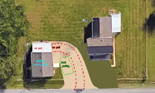

My suggestion is to add to the size of the concrete drive way in the following manner:
This gives you the option of backing up out of the car port in the new area toward the rear yard. Then you can drive in a forward direction which would be far easier to navigate by the truck and the corner of the house.
Additionally the part added onto the side nearer to the street view will allow the truck parking area to be moved over a little to alleviate the congestion posed by the parked vehicle in its current spot.
Adding onto existing concrete like this is certainly doable but there can be some downsides including looks and joining the new to the old slabs. If those are of concern to you then you would be looking at taking out a good portion of the existing slab and replacing with all new. Cost factors can be a good aid in the decision path.

  • The problem is that you have the turn too tight, as you couldn't start the turn until you clear the carport. It would need to be much closer to the house. – isherwood Jan 31 '17 at 18:38
    @isherwood - I am not there building the forms!! The idea is approximate at best. – Michael Karas Jan 31 '17 at 18:43
    No, but surely you can picture what I described. A pickup would extend almost to the far side of your turnout before clearing the carport, right? Otherwise I like your plan. My dad and I used to pre-drive all layouts with a full-size pickup before forming anything. It's the only reliable way to do it. – isherwood Jan 31 '17 at 18:45
  • @isherwood - Well the owner has said it is a car that goes into the car port. They may be inclined to purchase a Mini Cooper or small Fiat. The pickup is certainly a large portion of the problem here. – Michael Karas Jan 31 '17 at 18:49
  • I'd hate to add any more concrete. The big grass yard will soon be an apple orchard and permaculture garden starting this spring. – Dan Mantyla Jan 31 '17 at 18:52

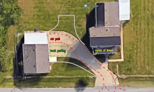

I would go the other way from Michael Karas. I'd eliminate the double S-curve, and make the entry to the carport a steady curve of same radius. That would cause it to miss the house entirely, and move "where the driveway meets the highway" west a bit. And get the ugly driveway away from the front of the house. Add a curb and you shouldn't have any house hits, it also gives you a place to throw snow.
Excuse my terrible photoshop skills.
Or, since 2 people duplicated my answer while I was drawing it, how about this novel minimum-pavement approach that puts your daily life more "in the green". Also improves sight-lines backing out (though I wouldn't back out; I'd back in.)

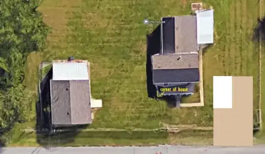

I'll throw an answer out there, answering my own question but not necessarilly the correct answer.
Remove the existing driveway and build a new one that makes more sense:
This has the upside of removing the driveway entrance from right in front of the house which I hate. Now I would be able to plant a big tree here! Downside is I will need to hire a crew with heavy machinery to dig out the old concrete and haul it away at the very least. I could replace it myself with turfstone pavers which I'm fond of, or just gravel which is just fine with me. Oh yeah and the 220v power going to the workshop from the house is going underneath the driveway somewhere and I don't trust that it's been burried with conduit or warning sand or anything.
And just becuase, I illistrated @MichaelKaras answer a little more to my liking, and add a paver curb at the driveway near the house, and this might be the best option:

    To avoid losing too much grass, make the turning area with those paving stones with holes in for grass to grow through. In German they are called Rasengittersteine, if you google it you can see the different types. – RedSonja Feb 01 '17 at 09:53
  • Oh yeah and there's another reason to shift the driveway to the left. Directly across the street from where the driveway currently meets the road is the driveway for a trailer park. Would be nice to have them offset a little to further the divide between my property and the trailer park – Dan Mantyla Feb 01 '17 at 16:09
Move the driveway like this, plant some trees and shrubs in front of the house

Well, the whole thing was designed very stupidly. You have two fundamental options: shoehorn some more driveway in place as @MichaelKaras suggests, or tear down the garage and build one more sensibly oriented, -- and preferable attached to the house! For example, draw a plan with the existing garage rotated 90 degrees and attached to the house roughly at that close corner. Use the area where the garage is now as your turnout space.
Or I suppose there's a third option: pave/gravel all along the front, parallel to the road and opposite the existing garage, and use that for your turnout space. That won't help with backing out of -- or into-- the garage, but it'll get you pointing forward to enter the street at least.

A less radical solution, perhaps temporary.

Based on your picture, I have an answer for you.
Drive in a straight line instead of randomly turning for no reason
Put a ruler on your picture. You will find there is an absolute straight line from the corner of the truck, along the driveway (and well away from the house), to the left-hand side of the entrance. The only reason you have an S bend is because for no reason whatsoever you've drawn the car as entering the driveway on the extreme right of the entrance. Unless the concrete on the left of the entrance is so damaged that you can't drive over it, there is no reason to be doing that. And if it is, fix it and you're done.
