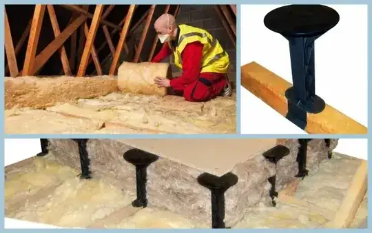

The UK DIY store B&Q used to sell 'Loft Storage Stilts' for this purpose.
enter image description here Image courtesy of http://loftstoragestilts.com/ used without permission, but hopefully attribution is enough
Alas they no longer seem to be selling these, so you may now need to contact the the original manufacturer or seek out alternatives.
A google shopping search found another similar product.
Mark Booth
  • ...except they don't anymore. They've been gone from the B&Q website for a couple of months now, after being sold out for a long time. I haven't found anywhere else that sells them. – Andy E Jun 01 '12 at 08:36
  • yup, I contacted them about a month ago with no response. Thanks for digging that up for me, I looked around myself but couldn't find anything else. It's just a shame they're so expensive ― £14.95 per 10 adds a lot of wonga to the overall cost of boarding. Would you recommend these over screwing additional wood to the top of the joists to raise the height? – Andy E Jun 01 '12 at 10:35
    @AndyE - That's a shame, it's always disappointing when you can't get hold of a product that would suit your purpose. I think if I were doing this, I would be inclined to make up stilts from lengths of 70x90mm timber, but it depends on whether time or money is more valuable to you. *8') – Mark Booth Jun 01 '12 at 10:51
    Just stumbled across this post - I've just done (part of) my loft using these stilts - they're back at B&Q (and Screwfix appear to have something similar too). – James Thorpe Dec 07 '15 at 14:14
