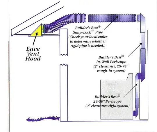

While I understand not wanting to have a vent on your roof, I would recommend either getting a low unobtrusive roof vent on the back slope of the roof or possible putting a vent out the eave or wall.

    If you vent out the eave and have soffit vents pulling air into the attic (for ventilation), you'll end up sucking the moist air up into the attic anyway. You can only vent to the eave, if you do not have soffit vents for roof ventilation. – Tester101 Jan 03 '12 at 21:06
  • Jim, this is brilliant. If I vent out the soffit it will be the most 'invisible'. I realize the drawing is a dryer, but the vent path is viable, right? Do they make 'eve vent hood' in many materials? sizes? – Trout Jan 09 '12 at 19:27
