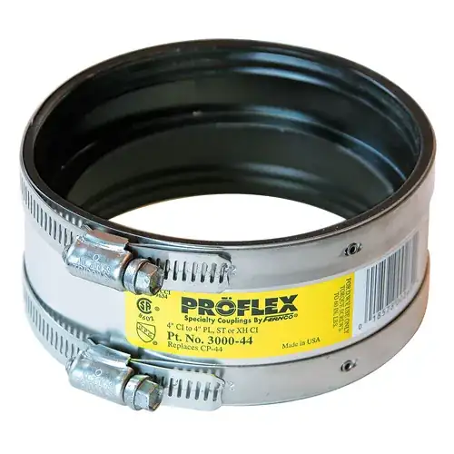

Is this the coupling I should use?

    See [Tester101's link](http://diy.stackexchange.com/a/20332/23295) for a, "4x3 rubber compression donut." – Mazura Feb 24 '17 at 23:11
  • @Mazura Thank you for the comment. Is there a way to connect the original 4 in. pipe to 4 in. PVC, instead of reducing the size? Would having a wider pipe reduce the risk of clogs? – Laxmidi Feb 25 '17 at 16:49
  • Sure, the one pictured is a 4x4". - Nothing you can get to flush down a toilet will clog a 3" pipe, but your codes may require 4". The trap in a toilet is ~2", so whatever IMO. 3" fittings are cheaper. – Mazura Feb 25 '17 at 17:29
    Make sure you use a heavy duty band, since this is in an inaccessible location. Also make sure it is specifically designed to use on cast iron on one side and ABS/PVC on the other. Check a good plumbing shop (as opposed to a "big-box"). – Jimmy Fix-it Feb 25 '17 at 20:56
