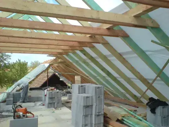

Last night we had high winds and the whole house was making this noise. The roof is made of wooden rafters. Something like this:

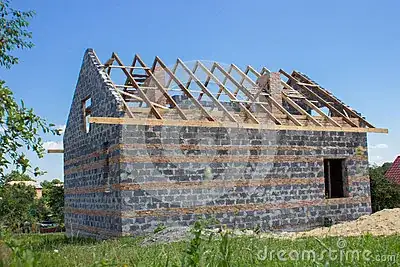

or
The wooden beams look much thinner compared to the ones used in Europe, see img below: enter image description here
The house will end up looking something like this:

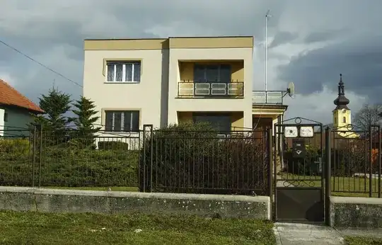

I actuallly lived in a house that looked similar to this one below:
I never experienced this house making any noise, wasn't even able to hear the wind outside.

  • The roof trusses are thinner, but are of closer pitch, commonly 30-40cm centers. Doubling the width of a beam does not double its strength, so more thinner beams may be better. We do have tornado-resistant structures in the US; they are called *missile silos*. Seriously, tornadoes are a *hard* problem. Tornadoes create an explosive underpressure (vacuum); the best anti-tornado buildings have intentional blowouts to depressurize the building with minimal damage. – Harper - Reinstate Monica Mar 01 '17 at 18:43
    @JimStewart I'm not sure where you get your information about Europe, but it's not very accurate. We certainly have (small) tornadoes, and sometimes 100-mph winds, in the UK. But the only wood-framed houses are likely to have been built around the time of Columbus, and if they have survived since then they probably aren't going to collapse in the next storm! The basic reason we stopped building wood houses (centuries ago) was the lack of wood. There's no sense importing wood from outside Europe just to build houses, when you can easily use locally produced bricks instead. – alephzero Mar 01 '17 at 19:07
    For what it's worth, the roof in 'European' picture looks really flimsy compared to how roofs are built in my area but that's probably related to the snow load. Generally roofs in my region would be built with 2 X 10s or 2 X 12s 16 inches on center. The euro-roof you show appears to have much wider spacing than the stick frames in your other pics. It's not just how large the boards and timbers are that matters, it's how far apart they are. For example, a house built with 2X6 studs can have more spacing between them than a house with 2X4 studs. – JimmyJames Mar 01 '17 at 19:26

Roof construction varies depending on where you live. In the north you need to build to contend with a heavy snow load so roof trusses are more numerous and stronger. Sothern climes, not so much. Further, the roof cladding makes a difference. Many roofs in Europe are covered with tile or slate, which is heavy and needs the extra support.
All buildings will creak and groan to some extent in the wind even steel high-rises. Though you may not notice in stronger buildings.
As for tornadoes.... If the roof blows off.. the drywall wont matter.
In some cases, wood frame is actually better than say brick. A wood frame house will creak and groan and bend, but except in the strongest wind, will not, if constructed correctly, catastrophically fail like a brick or cinder build building. In hurricane areas you will often find the timber frame buildings still standing surrounded by piles of rubble. Same goes for earthquake regions.
One more thing though. Creaking and growning is ok... Banging is not and is an indication that a roof panel has come away from its fastening and should be corrected immediately.
