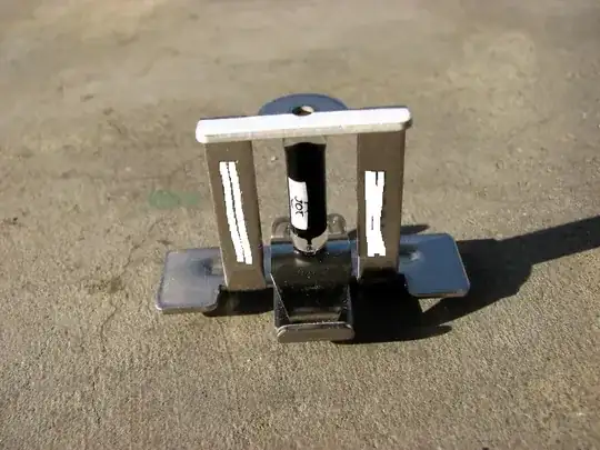

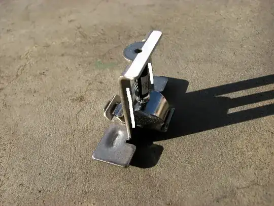

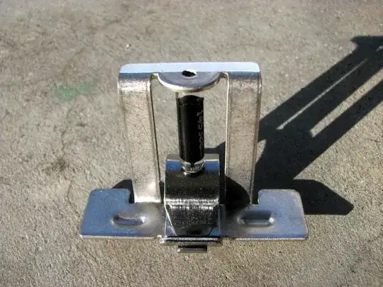

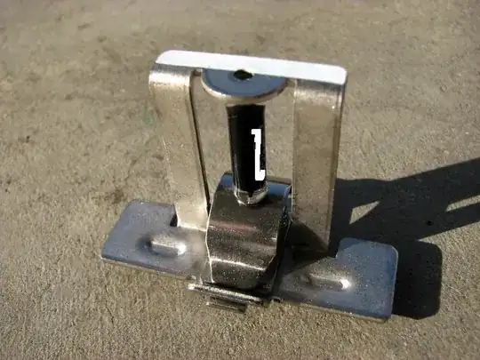

Got some pictures of the device
TRD-01 TRD-02 TRD-03 TRD-04

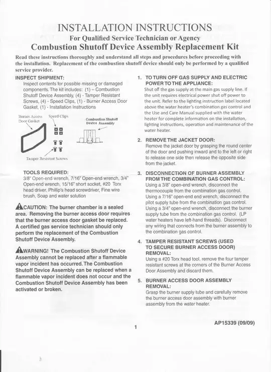

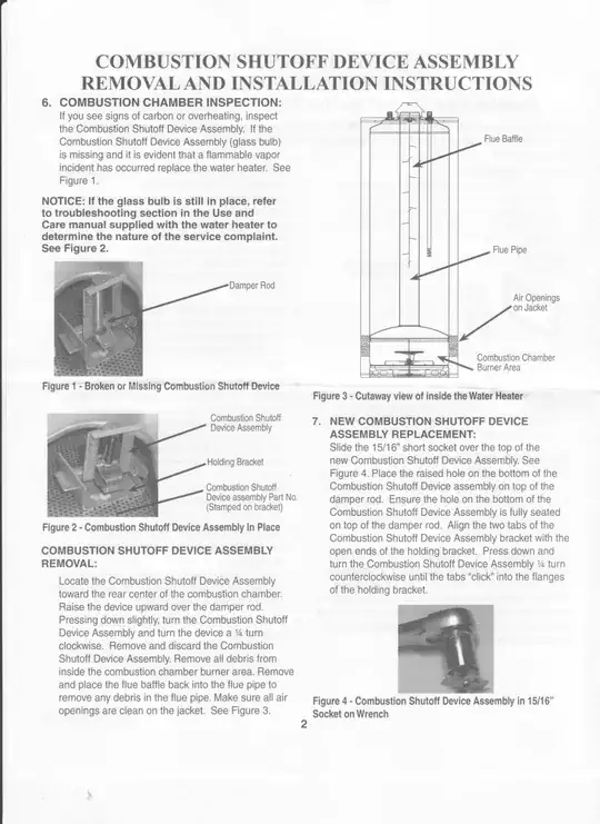

and instructions
TRD-Instructions-01 TRD-Instructions-02 TRD-Instructions-03

  • Posted the picture of device and the instructions that came with it. – amit_g Dec 31 '11 at 02:01
  • @Tester101, thanks for the research and information. As per the GE technical support TRD is federally regulated device and can be replaced at most once. If this happens again, the water heater has to be replaced. – amit_g Dec 31 '11 at 02:01

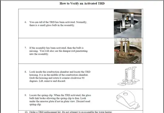

Here's a link to a safety bulletin (Rheem/Ruud)
Visually, it's pretty self-explanatory in the sequence below. Bulb pops, spring jumps out of the way and pin on spring loaded damper no longer is obstructed from allowing damper plate to seal combustion chamber.
excerpt from safety bulletin
