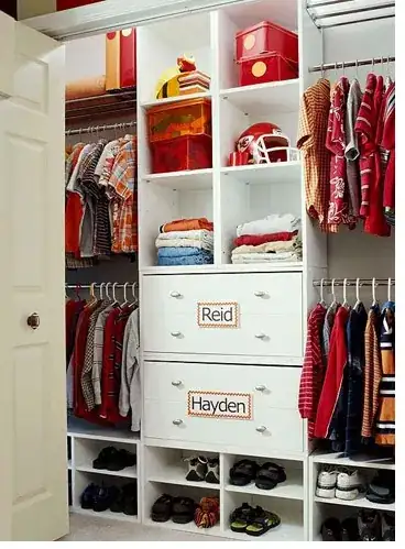

I'm planning to build some cubbies and drawers based on the design in the picture in a closet in my house.
I'm planning to use plywood for most of it. I've seen some designs use glue and dowel pins to connect the components, others just use glue and finishing nails.
What are the advantages and disadvantages of these two methods?
