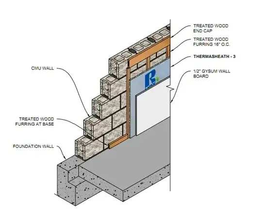

I am planning on insulating the lower level of my house with R-Max in a method similar to this:
R-Max Install Diagram
I have a few question about it though:
  1. Can I use something other than Treated wood as this is going inside my house? Maybe cedar?
  2. Where does my electrical fit and mount into all this?
  3. I am planning on using vertical wood paneling rather than Gypsum Board (see image below). I know R-Max is fairly tough and rigid but it does not seem like the most solid thing to mount something too?
  4. What about piping/ducting for hot water radiators/vents? Isn't the best place to have these is under the windows for circulation?

  1. I don't know. But I'm not aware of any reason not to put treated wood inside a home, and treated wood inside against masonry has been recommended numerous times by others on this site and elsewhere.
2-4. Electrical boxes, piping, and panelling must all be mounted to a stronger surface than poly insulation, as you suspected. You would need to mount to the furring strips, whether the insulation is behind or in front of the strips.
You cannot use regular thin wood panelling to cover R-Max. It requires a thermal barrier, such as 1/2" drywall, 1/2" plywood, 1" masonry, or 1" wood. This is for two reasons, as I understand: (1) to keep it from burning in an existing fire, as it emits harmful gases when it burns, and (2) to avoid exposing it to too much heat so that it doesn't ignite on its own. This is described on page 3 of the Thermasheath 3 data sheet.
I used this product in my own basement reno earlier this year, and it worked as advertised. I put it directly against the poured concrete wall with adhesive, then built 2x4 walls against the insulation. However, if I had to do it again, I'd consider having a contractor put in spray foam insulation, for a couple of reasons: I would gain two inches of floor space against each outside wall, and I wouldn't have had to do any air sealing above the foundation (my basement is only about 5' into the ground) and at the joist headers, which turned out to be quite a large job.
