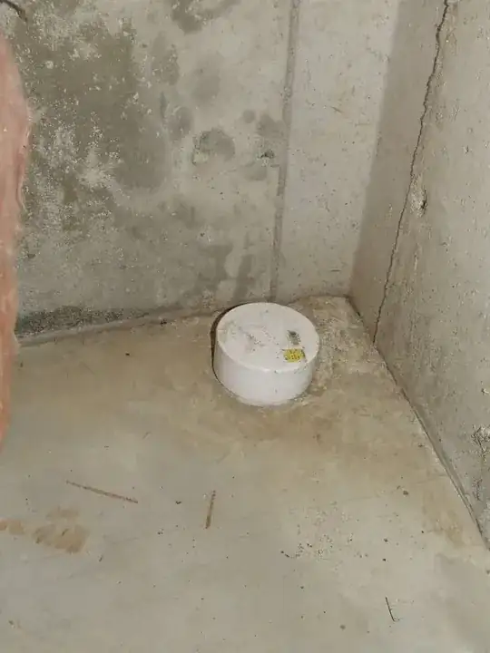

This pipe emerges from the concrete slab floor in a corner of my house's full basement. I believe it's a 4" polyethylene sewer pipe (narrow walls, black interior, white exterior). I can't tell if it's perforated or not below the surface.
Polyethylene sewer pipe emerging from basement floor, capped Polyethylene sewer pipe emerging from basement floor, uncapped
As you can see from the picture it goes down 4 feet. From that point it bends and appears to penetrate horizontally through the adjacent frost wall. (I know this from fiddling with a tape measure and a flashlight.)

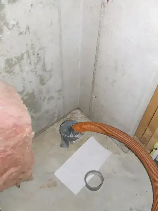

When I uncapped it, I noticed that air seemed to be blowing out of the pipe into the house, and I wondered if it was connected to either of the mystery pipes that emerge from the ground at opposite corners on the outside of my house.

I eventually convinced myself that the pipe is connected to the nearer of the two exterior pipes. (I did this by putting a vacuum down the pipe inside the house and noticing that the nearer exterior pipe was sucking air when I turned on the vacuum.)
Polyethylene sewer pipe emerging from basement floor, with vacuum

I am about to finish the basement room, and I intend to wall off access to the pipe. But I would like to know what it's for before I lose access to it forever.
