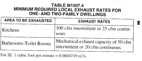

International Residential Code (IRC), says the minimum intermittent exhaust rate for a kitchen is 100 cfm, while the minimum continuous exhaust rate is 25 cfm.
M1507.4 Local exhaust rates. Local exhaust systems shall be designed to have the capacity to exhaust the minimum air flow rate determined in accordance with Table M1507.4.
Table M1507.4
So you'll want to make sure the hood is at least capable of achieving these flow rates.
