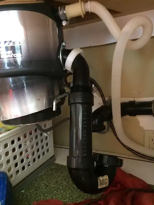

I have a kitchen sink that is recently backing up when I run the sink. I ran the garbage disposal thinking this would solve the problem but once I turn off water (lots) bubbled up into the sink. If I just leave it, the water does drain out. And in fact I thought the problem was fixed because I rapidly poured a whole kettle of boiling water down the sink and it all quickly flowed down the drain. I reheated kettle and repeated 5 times. We even ran the dishwasher over night and as far as I can tell, it got the dishes clean and didn't back up (no water in dishwasher). But when I turned on the sink and the garbage disposal in the morning, same problem. Water comes gurgling up.
I'd like to know
  1. Why do things seem worse when using garbage disposal?
  2. What's going on and how do I fix it?
I did see this article: Water backs up in adjacent sink only when garbage disposal is used
and maybe that addresses my problem? But note that I just have a single drain not a double one.
Thanks! Dave
Update. Photo shows plumbing under sink. Notice I was able to undo bottom connection of trap but NOT top connection. I unscrewed the fastener. Should it just pull down now? For the life of me, I can't budge it. AND I may have caused leak from pulling/twisting. Seemed like water was coming out when I ran garbage disposal right now metal fattener on outside of disposal (connector to tube) Adding photos as requested: UnderSink
Dave

  • Thank you everyone. I figured out the problem and how to call a drain service! I took trap off and examined it and garbage disposal. All clear. Problem was blockage 15' down line. That's why it would slowly drain over time. I tried to snake it myself and changed a slow drain problem to a "no drain" problem. Plumber brought power snake and fixed it. – Dave Apr 17 '17 at 20:43

  • Thanks for the answer. I updated the question with picture. Basically, I'm having a hard time getting trap off. Is there a trick? – Dave Apr 08 '17 at 13:06
  • That picture helps a lot. For actually removing the trap, it looks like you loosened the top part of the trap so it should pull free. Maybe rotate it a bit back and forth. And pray no glue got in there. If it won't come loose I would put a bucket under the open part, run some water in the sink and see if it is free-flowing to the back of the trap. If it is clear to that point then the problem is further down inside the plumbing somewhere, which means running a longer snake in towards the back. – SDsolar Apr 08 '17 at 19:42

Sounds like you have a single basin sink with the disposal underneath. A picture of the plumbing would help.
First thing I would do on a standard sink is pull the trap. Normally it should be there in a way that you unscrew two connectors and it comes free (have a bucket and some towels ready.
Normally there should be water in the trap, but not much in the line away. Examine the trap and see if it's got a blockage. Look in the line away and see if it's clear. If there's a blockage, clear it with a snake.

  • BowlOfRed, You mentioned two connectors for trap. You can see in my photo that I disconnected bottom one and it came away freely. Is there a trick with the top one? I unscrewed fastener and though I'd be able to just pull down, but no luck. Also notice I may have water now coming out near metal fasten between disposal and pipe. Is this adjustable? Thank. – Dave Apr 08 '17 at 13:08
  • @Dave, yes normally you should be able to simply pull down on that straight section of pipe to remove it (since you loosened the SJ (slip-joint) nut), but there's always a chance someone did something screwy and glued it. You can remove the metal plate to get that assembly off if you need to, note there is a *special* rubber gasket behind that plate (special and specific to your disposer brand- I.S.E.), if it leaks now (or later) you made need to purchase a new one. It may seal up fine when you reassemble things. – Jimmy Fix-it Apr 08 '17 at 15:03
  • Exactly. I would take the pipes on both sides of where the upper ring was and *gently* rock them to see if it's just stuck together. Also at this point if you have a snake you can probe either the trap or the line and see if there's a blockage. – BowlOfRed Apr 08 '17 at 15:36
