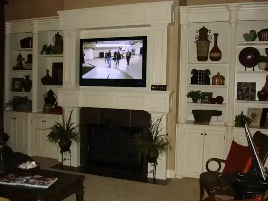

I agree with @DA01 that it'll basically be impossible to fish horizontally through studs and insulation, without having to cut open all of the sheetrock. Then you have to deal with sealing it all back up air-tight, and patching the drywall and repainting (at least the entire wall, and maybe the entire room, depending the paint match).
So a couple alternatives:
Use a wiremold type product to surface mount the conduit:
There are lots of different brands, and it can be paintable. With planning, you can minimize where you see it.
Build up the wall using cabinets or a false wall, so you can run wire in behind, on top of the existing wall.
Could be as simple as just a drywall section sticking out, or some built-in cabinets or some brick work. Cabinets of course have the benefit of being able to build in other components such as your A/V gear and speakers.
gregmac

    Good call on building out the wall. In fact, you could even use some form of paneling (such as nice cherry plywood or the like) where it floats from the surface but open in back. That lets you easily run wires but remain visually out of site. Ikea uses this technique in a lot of their AV cabinetry systems where the TV mounts to a panel within it rather than the wall itself. – DA01 Jan 11 '12 at 08:08
If it's sheetrock, I'd bite the bullet and cut out a section. Then you can easily remove insulation, drill studs, insert smurf tube and fish everything through easily. With the smurf tube, it should be easy to re-fish future cables as needed. (though with any luck we'll finally have wireless HDMI sooner or later...)
Yes it means you need to patch, tape, mud and paint when done, but that's likely easier than having to try and do it behind the wall as you go.
And I know asked us not to mention it, but I can't let it pass for the sake of other readers...be sure you really want it there. TVs above the fireplace look great in magazines, but typically lead to really sore necks in reality.
