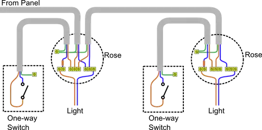

Typical wiring for UK light circuits
Diagram of lighting circuit
Notes
  • The brown tape on blue wire indicates switched live (this blue wire is not neutral). Sometimes this tape falls off and gets lost.
  • Grey cables are "twin and earth" (T&E)
  • The cable between switch and rose should ideally be "twin brown and earth" with two brown wires. Most electricians just use the ordinary T&E and use tape to mark the blue wire.
  • Some electricians swap the position in the rose of the brown and blue from the switch. When you see the blue connected to two browns you are expected to understand what the electrician did.
  • Older homes will have T&E with red and black instead of brown and blue.
  • Earth wires are bare copper. Green/Yellow striped sleeving must be added inside ceiling rose (or in other junction boxes etc)
  • Ceiling rose contains all connectors needed.
  • Last light on a circuit has fewer wires in the rose.
