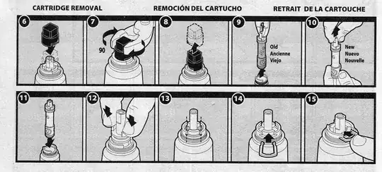

I have a single-lever Moen kitchen faucet that's 12 yrs old and I'm trying to replace the original cartridge. Moen sent a replacement cartridge (1225 B), that includes a removal tool. I've removed everything that is supposed to come apart up to this point, including the retaining clip that holds the cartridge in. The instructions at this point look like this:
instructions
The cartridge is completely circular, nothing keyed. It has O rings top and bottom to seal it. The removal tool is a plastic cap that fits around some wings in the top of the cartridge. You are supposed to use it to twist the body of the old cartridge. The only obvious purpose for this would be to sheer any built-up scale that might be stuck in the various openings, or just to generally loosen the body.
