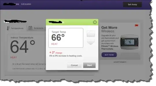

Some of the more advanced thermostats will track how often they are running. I have a Filtrete Wifi-Enabled Progammable Thermostat. It gives you a per-day total of how often the heat and A/C are run. You can also download an hour-by-hour export of the usage in CSV format.
I am in no way affiliated with this company. It is simply a product I have installed at home
It also gives you an idea, for a given temperature change, what the % change in heating cost will be:
Web Portal

  • I really like this, and I'm debating just buying one given the price is right.. for now I might just take meter readings until I see other options as well. +1 nice tool – Tyler Jan 12 '12 at 21:08
    I love this thing! There is an android app, iphone app, ipad app, cloud management.. and for $100, how can you go wrong?! the only thing you need to verify is that you have a wire at your thermostat connected to your furnaces C terminal. If you do not you either need to run an new wire or use a transformer to power the thermostat. – Steven Jan 12 '12 at 21:10
