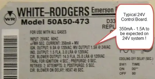

The 24V system in a HVAC typically has a fuse or breaker for either 3 amps or 5 amps. Sometimes it is a fuse on the control board and sometimes it is a breaker built into the transformer.
Typically, the current is about 0.5 amp - 1.5 amp in the 24V system when the AC or heat are running. The 24V control board usually shows the expected current flow.
At 1 amp in a 24V system with the thermostat 50 feet from the HVAC control board (100 feet total -- 50 feet of red or yellow plus 50 feet of white make the circuit ) there is a 1.5 volt drop through the resistance of 100 feet of 18 gauge wire. If you drop that wire down to 24 gauge, then there is 5.3 volt drop at 1 amp across the same distance.
That's in a normally operating system. If the system has a problem and runs 3 amps it might not trip the breaker or fuse, so there would be no indication of a problem. At 3 amps in that same 24V system, there would be 16 volts dropped due to resistance in that 24 gauge wire, but less than 4 volts dropped due to resistance in 18 gauge wire. Remember that the only thing limiting current in this system is either a 3 or 5 amp fuse or breaker, so any system problem causing current just below those limits might go on indefinitely without any indication.
You're taking a heck of a chance of a fire by using 24 gauge wire in this application. Don't do it.
    Are you sure? HVAC thermostats are generally designed to drive a simple transformer, and 24VAC transformers generally take less than a few hundred mA to trip (the first one I saw used 40mA). 1A seems egregious; 3A seems like a fantasy. – Daniel Griscom May 16 '16 at 17:36
  • I have checked plenty of HVAC units out, and typically there is 0.5A to 1A running through the 24V system when it is engaged. –  May 16 '16 at 17:42
  • Yes, I'm quite sure about that, and the transformers used in these systems are usually either 24VAC 50VA or 24VAC 75VA. The thermostat doesn't do anything more than close a connection when needed. The 24V control panel on the furnace is what controls the whole thing. If you don't believe me feel free to take an ammeter and check the current going through the red/white (heat) or yellow/white (cool). –  May 16 '16 at 17:50
  • Your arrow is pointing to the "MV Output 1.5A 24VAC" line, which is the master gas valve output. This is an output from the controller, and is designed to supply plenty of current to switch a robust external valve. But, this has nothing to do with the thermostat input. Or did you mean to point at something else? – Daniel Griscom May 16 '16 at 21:45
    Just for fun, I measured the current through one of my thermostats in my house (gas modcon boiler). 100mA. I'm done here. – Daniel Griscom May 16 '16 at 22:03
