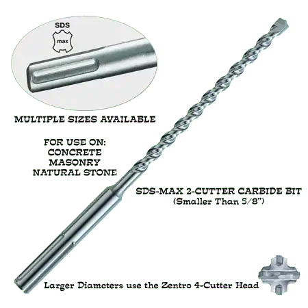

SDS Max Shank Carbide Bit:

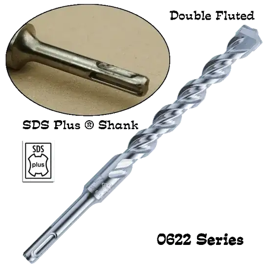

SDS Plus:
SDS Plus Shank Carbide Bit
