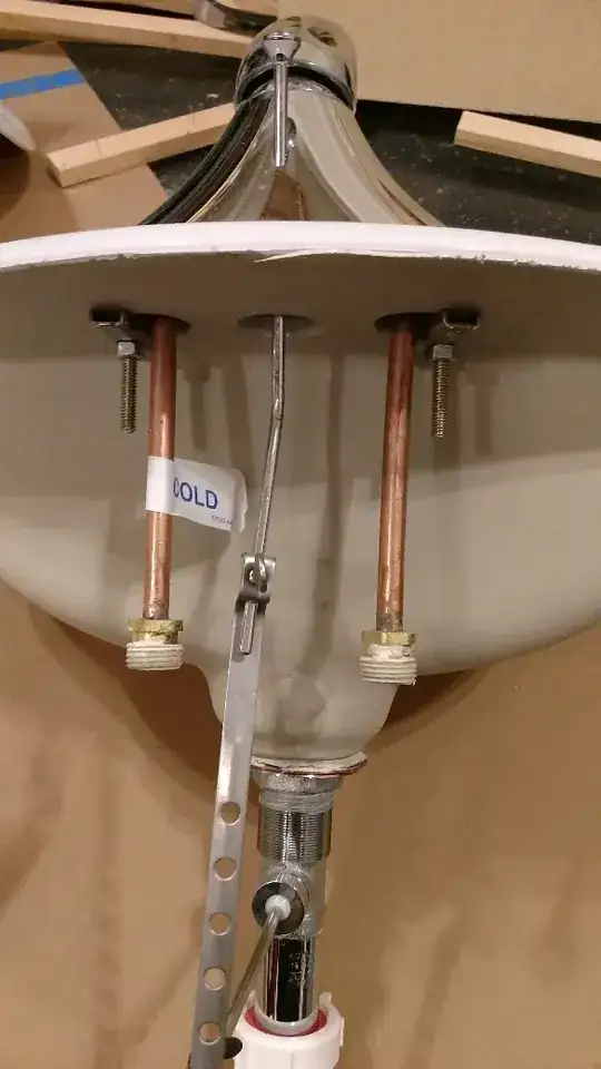

So I got new counters and faucets. Unfortunately, the old faucet had an extender on the supply lines that the new one does not, additionally, it doesn't appear to something i can swap from old to new. Due to this, the water supply lines are too short to reach the new sink. What is the best way to handle this?
Old sink connector
New sink connector

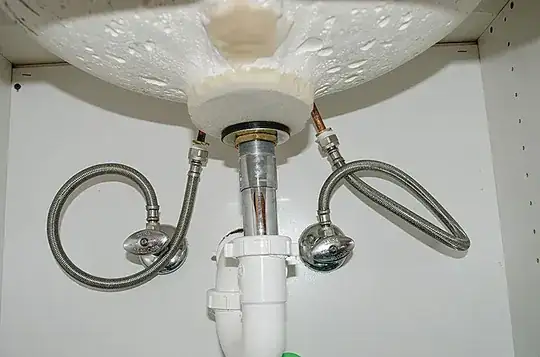

You typically use braided steel supply lines to connect the sink to your supply.
supply lines under sink
You can get anything from a few inches long to a couple feet long.
braided steel supply hose
