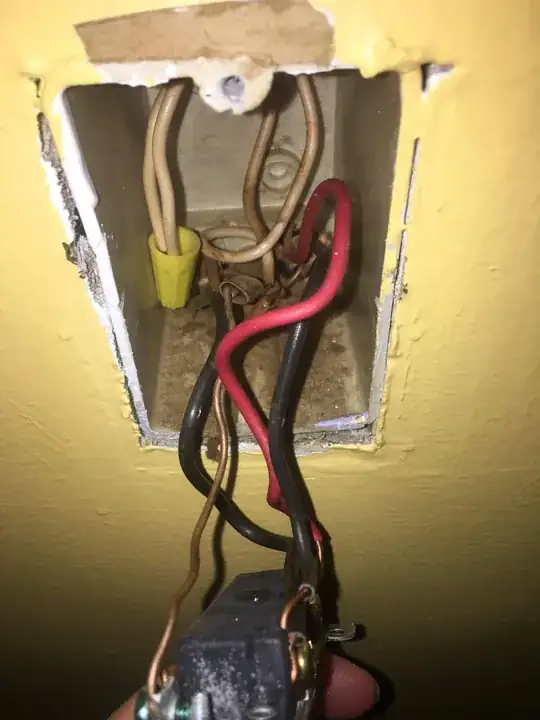

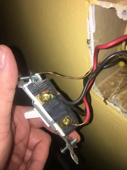

I have a bedroom that has no ceiling light. The bedroom is on the first floor, below our living room so there is no access from above. There is also a light switch that controls an outlet. I would like to install a ceiling light, controlled by that light switch and rewire it so the outlet is no longer controlled by the switch. The switch is not directly in line with the desired location of the light, so at some point I will need to go through a ceiling joist or a stud in the wall but I am not sure what is my best option. As a novice who has no electrical experience beyond changing out bad switches/outlets and simply rewiring them the exact same way I found them, I would appreciate as much information as possible on this. enter image description hereenter image description hereenter image description here
  • I take it both halves of the receptacle are switched? – ThreePhaseEel May 24 '17 at 00:20
  • Yes, top and bottom are on the switch – Alexander Baker May 24 '17 at 00:24
  • Additionally I have just been informed by my wife (we have been discussing this for 2 months) she has decided she may want a light/fan combo. Possibly controlled on separate switches. How much more difficult is this? I realize I may be not be giving enough specific information, but if we could at least figure out the wiring for the outlet/switch situation for now I will tell her she must make a firm decision by tomorrow evening. – Alexander Baker May 24 '17 at 01:18
  • It's not terribly difficult as long as you pull the correct (i.e. /3) cable between the light-location and the switch-location. Box fill is a potential issue, but fixable all the same. Are the existing wires 14 gauge or 12 gauge btw? – ThreePhaseEel May 24 '17 at 01:53
  • They are 12. I know 12 is required for outlets so I had just assumed (probably a dangerous thing), but I just verified they are indeed 12. – Alexander Baker May 24 '17 at 02:17
  • 12 is only required for *certain* receptacles (kitchen counter, laundry, bathroom, or anything else that's an actual 20A circuit) unless you have a local amendment that says otherwise, but good to know for sure. – ThreePhaseEel May 24 '17 at 02:20
  • One more thing: what size is the existing switch box? – ThreePhaseEel May 24 '17 at 02:21
  • It is 1 gang. Approx 2 1/4" wide, 3 1/2" high and 3" deep. If I go with the fan, and want two switches it is easy enough to pop that one out and replace with larger right? I saw something once about using a sawzall to cut the nails holding it to the stud and replacing with old work box. – Alexander Baker May 24 '17 at 02:55
  • Extension boxes are a thing, as well... – ThreePhaseEel May 24 '17 at 03:18
  • I have a feeling I will end up having to put in a fan/light combo with two switches. I will have to stop at the store tomorrow to pick one up. What other supplies will I need? Am I able to get a start on changing the wiring of the switch and outlet tonight, or will it be best to don't all tomorrow night when I have the fan also? – Alexander Baker May 24 '17 at 03:32

  • He'll definitely need a bigger box or an extension ring -- the existing box he has is already too small (it can only hold 6 fill units @ 12AWG while he needs 8 fill units of space as-is and 11 in the new configuration). – ThreePhaseEel May 24 '17 at 11:48

  • As for wiring the switch to make the outlet hot all the time, I connect the two wires that are already in the switchbox with wire nuts? Ground to ground, white to white and black to black to red? My understanding (obviously quite limited) is that red is also hot so I can connect red and black together. If this is indeed what I do, how will I get power to that switch now? Do I run pigtails from these newly connected wires to the switch? The wife has made a decision on light/fan combo. It can be connected to a single switch and light and fan controlled via remote. No need for 12/3 now right? – Alexander Baker May 24 '17 at 13:38
  • @AlexanderBaker Yes that's correct about the wiring. Connect the red and black to the black from the feeder, along with a pigtail to any switches for the light/fan. If you want to use a remote to control the fan/light you don't have to run 12/3. However, you might still want to, so you have the option in the future. Also, you're going to have to install a larger box at the switch location, since you're already over the box fill limit. – Tester101 May 24 '17 at 14:02
