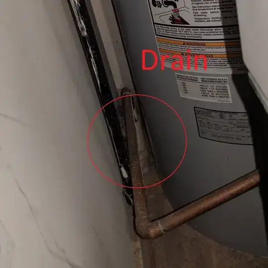

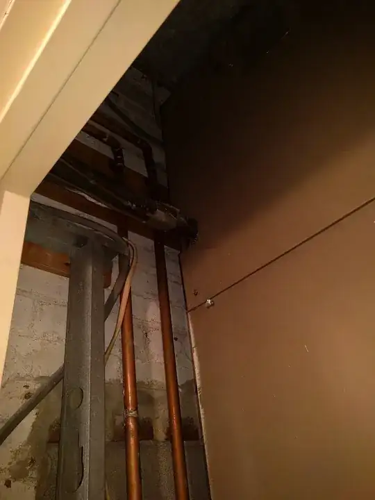

I recently moved into a condo unit in Washington, DC (2nd floor of 2 story building) and I'm looking to replace the 47-gal lowboy electric water heater that's from 2003. The problem is that there is no pan (we do have people that live below us) and, while there is a drain pipe, it's higher than the pan (see pictures below). I believe that the copper pipe connects the heater relief valve to the drain.
Also, there's no expansion tank.

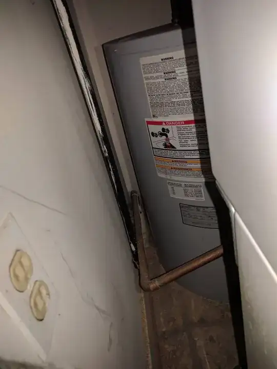

The heater is in a hard to reach location in the kitchen closet, behind the washer/dryer unit. To access it, I'd have to remove the fridge from the kitchen, take off the closet door, and pull out the washer/dryer.

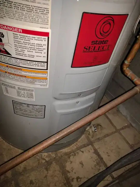

The tank is 31.5-32" tall and there's 19" of space above it. I'd likely have to get the exact same size replacement because the water lines coming in from the top aren't flexible. I'd ideally like a larger capacity tank because we don't get a lot of hot water with this one.
I've had 3 plumbers come in and all want to charge me between $1800-$2500 with a "play it by ear" mentality regarding the pan. Needless to say, that doesn't give me a warm and fuzzy feeling. I'd like to know exactly what is going to be done to address the pan issue because come time to sell down the road, it's important to me that the new heater will pass inspection.
Given the estimates, I'm tempted to try and do the job myself. But I need some guidance on how to address the drain being higher than the pan. One of the plumbers suggested trying to build up the floor underneath the water heater, but I don't know how feasible that is. Also, is an expansion tank necessary?

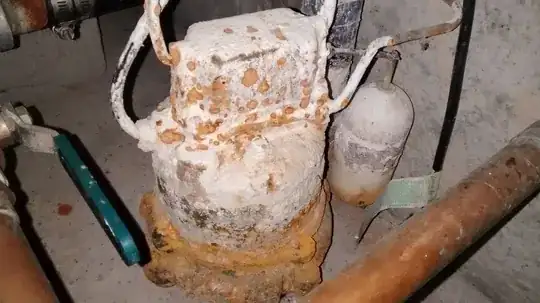

I'd really appreciate any advice on this matter. enter image description here enter image description here enter image description here enter image description here enter image description here enter image description here

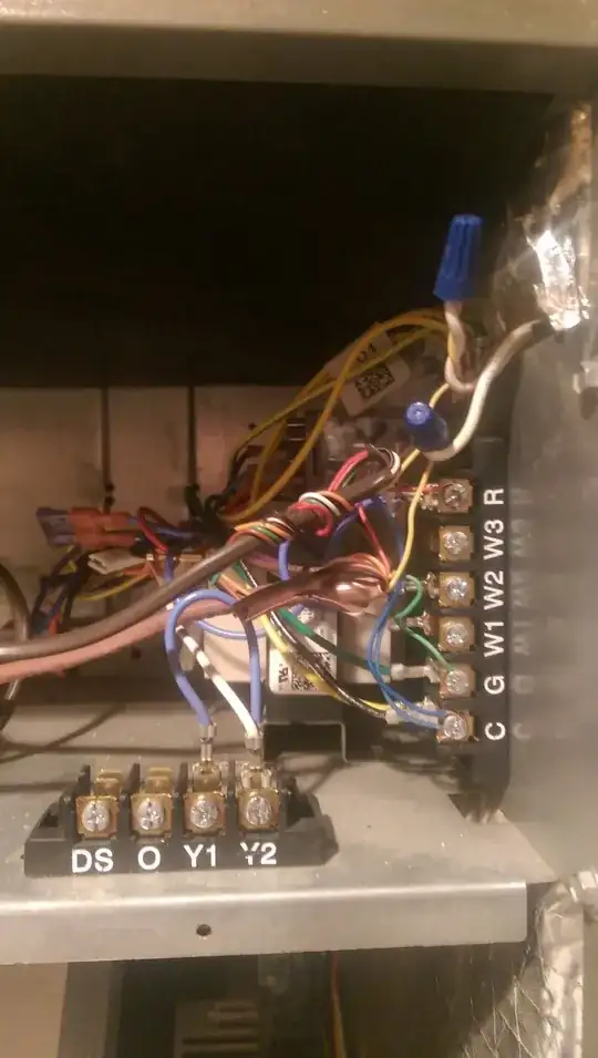

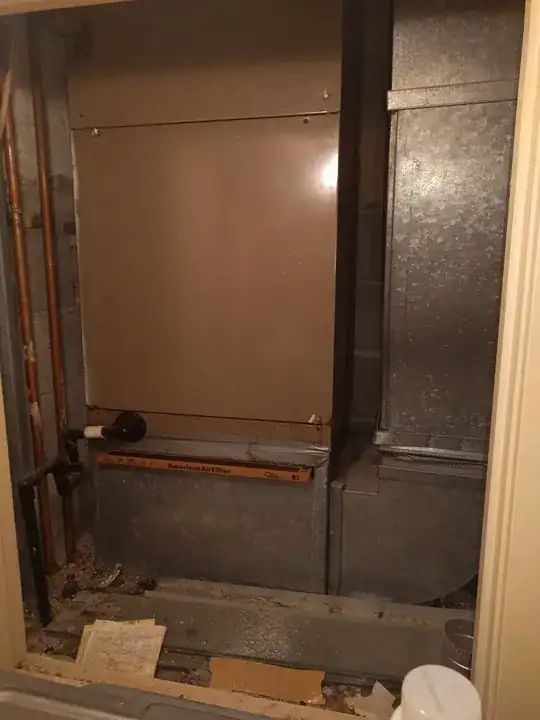

Adding pictures of HVAC as it relates to the discussion in the comments: enter image description here enter image description here

  • The exact same size replacement might not be feasible due to efficiency regulations requiring thicker insulation. One the exact same size externally will necessarily have a smaller tank. The copper tubing isn't flexible of course, but would be cut and fit for a new tank anyway, so you'll end up using that height if you want the same capacity. – Tim B Jun 02 '17 at 14:53

  • Is there any reason (code reqt or practical) for the drain to be that high off the floor? If not, you could cut it off say 4" above the floor, then put a new heater on a platform the same height as the drain so a pan could drain by gravity into the drain pipe. I assume the drain is plastic and so it could be cut off easily by a DIYer. If it is cast iron, it can still be cut off, but this would require a special cutter which one could rent. When you install a new tank you will cut the copper lines and you should connect the new heater with flexible lines with an insulating coupling. – Jim Stewart Jun 02 '17 at 15:41
  • Not sure if there's any justification behind the drain height, but I can ask other owners in the building about their setups. It appears to be plastic, so I think that cutting it would be a feasible option. What type of platform would you put the new heater on? – littleK Jun 02 '17 at 15:50

  • @Jim With "heat pumps" I was referring to our HVAC... but you raise an important question. What if his old water heater *is already* the heat pump exchange type? Probably not. – Harper - Reinstate Monica Jun 02 '17 at 16:01
  • Our HVAC is a heat hump, and it is positioned directly above the water heater. Not sure how I'd determine if the water heater is tied into it. – littleK Jun 02 '17 at 16:05

  • I've added two pictures of the HVAC that sits above the heater in case it helps with this discussion. It's at least 15 years old. – littleK Jun 02 '17 at 16:27

  • A suitable platform could be built with a 2x4 frame with 3/4" plywood on top, which you can make (and should) even if you have a plumber install the heater. Plumbers as a group are not especially good carpenters and with a little planning you can make a really good platform. Find out if there are any code or other requirements on the height of the drain. It could be that the height must be above certain other drains in the house. If you can't cut it off or don't want to, just make the platform the height of the drain as it is, and get a water heater which will fit on it. – Jim Stewart Jun 02 '17 at 16:50
  • There are commercially available stands required in most jurisdictions for water heaters in basements and garages. Usually they elevate the heater 18" which is more than you need and could possibly be too high for the heater you would want. See http://www.homedepot.com/p/Eastman-21-in-D-x-21-25-in-W-x-18-in-H-Water-Heater-Stand-86278/205365245?cm_mmc=Shopping%7cTHD%7cG%7c0%7cG-VF-PLA-D26P-WaterHeaters%7c&gclid=Cj0KEQjwmcTJBRCYirao6oWPyMsBEiQA9hQPbiDWsmb9T-MBOR2J0DD-ydbBpLtM2W4MN-ZtzzQWHFwaAnls8P8HAQ&gclsrc=aw.ds – Jim Stewart Jun 02 '17 at 17:01

  • Home Depot has a 24" square stand which you would probably need for a squat form electric tank, but it is 18" high which might be too high for your application, but maybe not. You should not cut off the drain until you find out for sure that it does not have to be say taller than the toilet bowl or the tub wall. This drain is in a not readily accessible space and in case of a sewer blockage you don't ever want it to overflow before other places do. – Jim Stewart Jun 02 '17 at 22:08
    Are you sure you need a *bigger* tank? I'd be grading tanks based on first hour recovery, not size... – ThreePhaseEel Jun 03 '17 at 00:22
  • I'm going to follow the advice @JimStewart and just replace with another tank. I'll build a platform out of wood to match the height of the drain so that I don't have to cut it. Then, I'll just get the largest tank that will fit in the space. I'll cut the copper water lines and replace with flexible hosing to allow for additional space. The only question I have now is do I also need to install an expansion tank? Thanks for all of your help. – littleK Jun 03 '17 at 14:44
