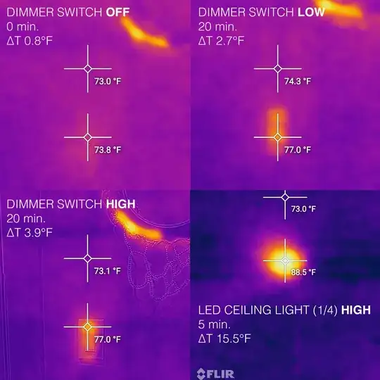

I am answering this question 10 years later, but with some fun data. Many of the answers focus on energy wasted as heat, especially at the dimmer switch itself. I used a thermal-infrared camera to measure temperatures at my dimmer switch. In each panel, the lower temperature reading is at the switch, and the upper temperature reading is on the wall next to it for reference.
thermal infrared images of dimmer switch and LED bulb
The dimmer switch "wastes" roughly the same energy (as heat) on high or low settings, but the light "wastes" much more energy as heat than the switch. So dimming the light saves energy.
Here are some details from the data:
  • Even with the switch off, some heat is generated. This seems to be because of the locator light that is always on by default.
  • The dimmer switch seemed to heat up one degree more on the high setting. I'm not sure how accurate the thermal camera is.
  • The light itself produces a lot more heat, and the switch controls 4 lights. Using the Stefan-Boltzmann law, I estimate that with the dimmer switch on high (bottom row of images), I'm producing about 18x more power in heat at the LED lights than at the dimmer switch.
There is a lot of (sometimes contradictory) info in the other answers about whether dimmer switches are usually thyristor or rheostat type. My particular switch is a Leviton, and I can't find the type on their website, but I get the general impression that those saying that rheostats are not used any more are correct. In any case, the Leviton website gave the following helpful table that also answers the original question for all types of bulbs:
