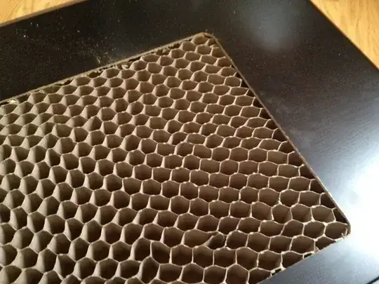

I was reading a bit about how strong the desk is, and it looks like the desk is likely too weak for the weight to be put on one 5cm x 5cm spot on the desk, due to the wooden panel's structure:
desk panel
So I need something to distribute the load across a larger surface of the desk. Probably something that's tough enough to actually distribute the load as opposed to something weak that will bend and just pass the load on the spot.

That's an edge mount. The edges of the table top will be solid wood. The honeycomb mesh is in the center. So there is no problem with clamping the mount there.
If still you don't trust it. You can use a strip of plywood or a bit of angle iron. Note that this will reduce the available depth of the clamp.
