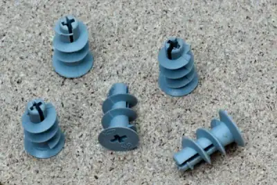

My current idea is to use a metallic threaded anchor like this:
but maybe I need several anchors just to make sure weight is distributed, or maybe I should use a different kind of screw/attachment?
