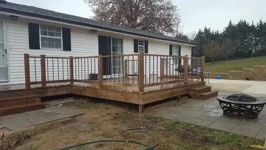

Existing deck 1 Existing deck 2
Please note the 2 posts on the left side away from the large square deck section. That is the old deck section that I sleeved the old posts. As alignment wasn't perfect, the post in the center is actually a "floppy post" to make the steps more aesthetic on each side of the steps. But with the composite sleeves make them look like 6x6's and adds structure to the 4x4 posts.

  • Yes, They are anchored into 12" diameter concrete footings 5' deep. I put the deck in just last year and had a friend with a skidloader auger that put the holes in for me and we poured them with reinforcement. Now my wife wants a Pergola over it. I don't relish the idea of digging those monstrosities out to redo every corner of the deck. That is why I'm looking at extending the existing posts. – Brendan Sanders Jul 14 '17 at 14:12
  • Photos and added preliminary pergola design. I can easily place 6x6 angle braces up from the vertical posts and slide them between the horizontals. I would want to limit the angles on 3 sides since I don't want them to restrict the walking areas as 3 of the 4 legs are either near stairs off the deck or the narrow part of the deck that lead off the remainder of the narrow wrap-around deck to my house. Would 12" braces added each direction be enough? I could add 2' braces each direction on the one corner, which is where the predominant winds would come from. What do you think? – Brendan Sanders Jul 14 '17 at 15:00

  • That is why I plan on placing sleeves over them. They make them the same diameter as a 6x6 and the composite material does add some structure, not just a metal sleeve. I sleeved the posts on another older section of the deck and it looks quite nice. I could see the advantage to diagonal bracing each direction, and it would add to the look quite nicely. Thanks for the suggestion. I'll try and post some pictures of the existing deck. I will reset the rail between the legs which should add to the stability of the existing legs somewhat too. – Brendan Sanders Jul 14 '17 at 14:21
  • Would I be better off cutting the footing posts off a the deck level and then attaching new 6" posts to the deck be a better option? I'd think that would reduce the stability over using the 4x4's that are anchored in the ground. If I would have just known that she wanted to then put a pergola on later, I would have upgraded them to 6x6 and placed full length needed at the time of building the deck last year. But what I've got now is what I've got. I just need solutions if it is at all possible to be done. – Brendan Sanders Jul 14 '17 at 15:26
